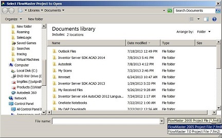

Here are the steps to open the .FM2 files in FlowMaster 2004 and V8i:
1) Open FlowMaster
2) Go to File > Open.
3) Now pick the file type .fm2 in the Open File dialogue in the bottom right-hand corner.
Browse to the location of the .fm2 FlowMaster file.
Highlight the file name and click Open.
IMPORTANT: make sure you perform a save-as once opened, to properly save in the new format. Otherwise, the model will be saved to the Windows temporary folder (%temp%\Bentley\)
