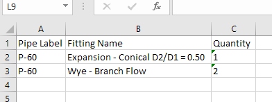

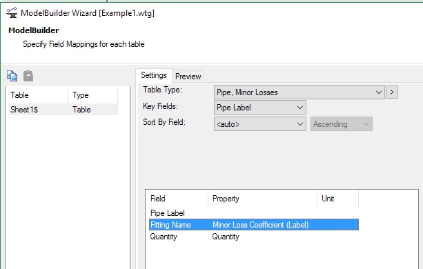

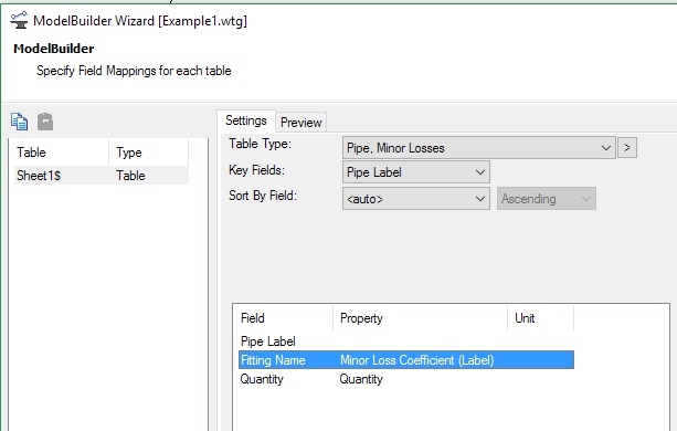

In the pipe properties, if you have selected "False" for "Specify local minor losses", you can enter a list of specific minor losses in the Minor Losses collection. You can specify multiple minor losses per pipe. To export this for reporting purposes, you can set up a spreadsheet and connection in Modelbuilder using the table type "Pipe, Minor Losses".
Create a spreadsheet with columns for Pipe Label, Fitting name and quantity, then map to these fields in Modelbuilder, using the pipe label column as the Key Field.
In the last step of Modelbuilder, choose No when asked to build the model. Then, back in the Modelbuilder manager, select the entry corresponding to the spreadsheet and click the “Sync out” button. You’ll then have a spreadsheet with the list of fittings and quantity for each pipe.
