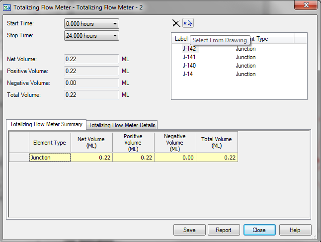

How can I find the total volume of water through a certain element in SewerCAD and SewerGEMS?
Starting with OpenFlows Sewer 2026 and OpenFlows Storm 2026, you can now use the Totalizing Flow Meter for both conduits and pressure pipes when using the Implicit, Explicit, or GVF-Convex solvers. The Totalizing Flow Meter can be access through the Ribbon interface (Analysis > Analysis Tools > More > Totalizing Flow Meters) or by right-clicking on an element and choosing Totalizing Flow Meters. For the GVF-Convex (SewerCAD) solver, this only applies to EPS calculations, not steady state.
For further information, see the information below.
If you're using SewerCAD or the GVF-Convex solver in SewerGEMS, you can use the following approach:

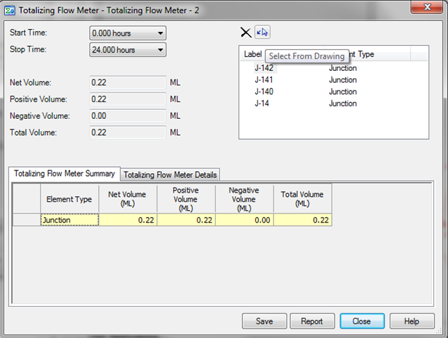

1) Use the Totalizing Flow Meter tool to view water volume over a certain time period. Right-click on the element and choose "Totalizing Flow Meters." Or in the CONNECT Edition, access the tool from Analysis > Analysis Tools > More > Totalizing Flow Meters. In this tool you can select the time frame and report water volume. Multiple elements can be selected at once by holding down the CTRL button on your keyboard and left clicking to select the elements. Click the Totalizing Flow Meter Details tab to see more details. Click the "Select from Drawing" button in the upper right corner to select multiple elements.
Note: The Totalizing Flow Meter now applies to gravity and pressure elements.
2) Right click the outfall, choose Data Table, select the "Volume (Total out)" field (under the section "Results (Flow)"), click OK and scroll to the bottom of the table. The volume at the last time step will be the total volume of water that has left the outfall.
3) Open the Time Browser under the Analysis menu, then select the last time step. Then, look at the "Volume (Total out)" field in the properties of the outfall. This will show the total volume of water that has left the outfall.
