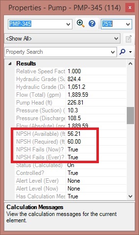

Starting with CONNECT Edition Update 1, a NPSH Required field is available in the  Pump Definition for a pump. To include NPSH analysis in the calculation, check the box beside “Define NPSH Required Curve for pump cavitation check?” You can then include flow and head values that represent the required head and flow to satisfy this.
New results fields “NPSH (Available)” and “NPSH (Required)” are available in the pump properties and pump FlexTable. “NPSH (Available)” is the NPSH calculated by the program; “NPSH (Required)” is the NPSH derived from the table you entered in the pump definition.
After computing the model, the program will check if the available NPSH calculated in the model is greater than the required NPSH entered in the curve. New property fields “NPSH Fails (Now)” and “NPSH Fails (Ever)” are also included to report if the NPSH fails for current time step or any time in the simulation. If the available NPSH is less than the required NPSH, this will return a value of True. If the available NPSH is greater than the required NPSH, a value of False is returned. This can be useful with queries and color coding.
User notifications are generated when the NPSH requirement fails, enabling you to see which time steps may be impacted. It is also possible to graph the available and required NPSH to see a graphical representation of the results over time.
