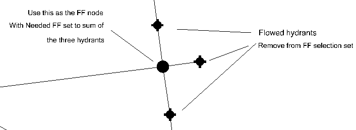

1) Use one single node to represent all of the hydrants that will be flowing, and use automated fireflow. For example if you have three hydrants that need to provide 1000 gpm, consider the needed fireflow to be 3000 gpm, then use a junction in the vicinity of the hydrants in question as the fireflow node. You'll then need to ensure that you have enough hydrants to deliver that 3000 gpm. If all other fireflow nodes use a global Needed Fireflow, choose "true" for "specify local fireflow constraints" on the junction representing the three hydrants (or check the box in the table at the bottom of the fireflow alternative) and enter the specific Needed Fireflow of 3000 gpm. If you have separate hydrant elements in the model, remove them from your fireflow selection set, (so that the automated fireflow routine only computes the junction, instead of the hydrant elements). You can do this by selecting the hydrants, right click in the drawing, choose "remove from selection set", then choose the fireflow selection set. Open the fireflow alternative to refresh the list of fireflow nodes based on that selection set. Also make sure that the junction in question is included in the fireflow selection set.

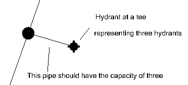

2) If lateral losses may be significant, consider using a hydrant instead. For example if three hydrants need to flow at the same time, each with a needed fireflow of 1000 GPM, combine the hydrant nodes into one, located near the middle of the three and adjust the lateral pipe to be the equivalent of the three lateral pipes. Place the 3000 gpm needed fire flow on that new hydrant.
If your hydrant is connected to the water main via a pipe element (at a tee), then adjust that pipe's property (the pipe element, not the separate "lateral" element)

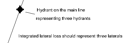

If your hydrant is placed in-line with the water main (not at a tee), then ensure that the property "Include hydrant lateral losses?" is set to "true" for the hydrant, then enter the equivalent diameter pipe (representing the three lateral pipes).
