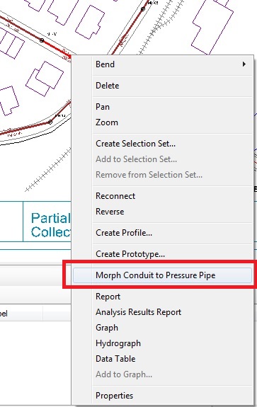

Is it possible to change or morph a conduit into a pressure pipe or vice versa?
There are ways to morph link elements like conduits and pressure pipes into another link. There are two possible ways, depending on the number of elements to be changed.
1. Use Morphing function
If you have only one or a handful of links to alter, the simplest method is to use the morphing function found when a user right-clicks on a link. For instance, if you want to change a conduit into a pressure pipe, right-click on the conduit and choose "Morph Conduit to Pressure Pipe".
After selecting this, the conduit will change into a pressure pipe and retain properties that the two elements share, such as diameter and material. If you select a pressure pipe to morph into a conduit, the right-click menu will state "Morph Pressure Pipe to Conduit" instead.
