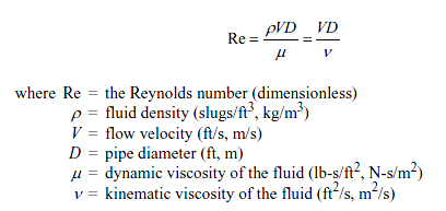

3. The Reynolds number is calculated based on that Velocity

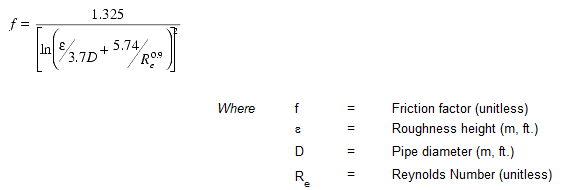

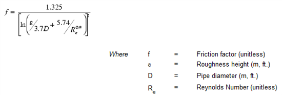

4. The Swamee-Jain equation is then used to solve for the friction factor, f

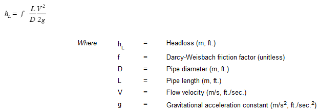

5. The Darcy-Weisbach equation is then used to solve for the headloss

Reynolds number:
Swamee-Jain:
Darcy-Weisbach:
