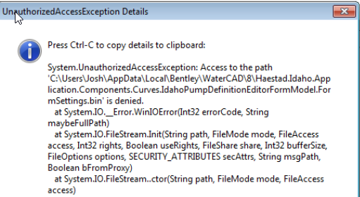

The following error are being returned.
"System.Unauthorized.AccessException: Access to the path "<FilePathLocation>" is denied"
This has been known to occur when doing one of the following:
UnauthorizedAccessException Details
System.UnauthorizedAccessException: Access to the path '<FilePathLocation>' is denied.
at System.IO.__Error.WinIOError(Int32 errorCode, String maybeFullPath)
at System.IO.FileStream.Init(String path, FileMode mode, FileAccess access, Int32 rights, Boolean useRights, FileShare share, Int32 bufferSize, FileOptions options, SECURITY_ATTRIBUTES secAttrs, String msgPath, Boolean bFromProxy)
This error appears when the software cannot access or save to the folder location specified.
The following steps may require the assistance of your company's IT department
Solution 1: Set the software to "Run as Administrator"
Solution 2: There is an issue with an output file
Solution 3: The model files are located on a CD or DVD
Solution 4: There is an issue with the software installation
