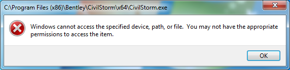

When trying to open a Bentley OpenFlows product the following error appears and the program does not open.
"Windows cannot access the specified device, path, or file. You may not have the appropriate permissions to access the item."

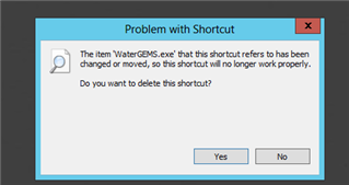

OR
For Connect Edition Update 1
After this if the shortcut is created from the installation folder on the desktop, then the .exe is removed from installation folder.
