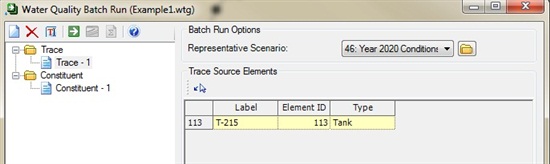

The Water Quality Batch Run feature allows you to perform a combined Trace or Constituent analysis. You can then use the provided reporting tools to graph the combined effects of each type of analysis on various parts of your system, or to review system-wide tabular statistics reports.
To create a new analysis, highlight either Trace or Constituent from the list on the left and click the New icon at the top. For each type of water quality analysis, you will need to choose a representative scenario. This is the scenario that the analysis will be conducted on. Depending on whether you choose Trace or Constituent, the left part of the dialog will look different.
For a Trace analysis, you will need to select the element or elements in the drawing on which the Trace analysis will be conducted. This is done by selecting the “Select from Drawing” below the Representative Scenario pulldown.

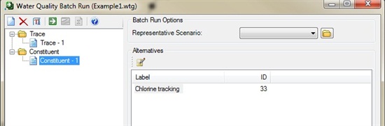

For the Constituent analysis, you will need to choose the Constituent alternative that will be used during the analysis. This is done by selecting the “Select Alternatives to Analyze” icon. Note that the Constituent alternative must already be created and contain the constituent source and data.
After the data is selected, highlight the type of analysis and click the compute button. You can view the results as a table or as a graph.

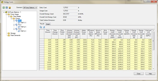

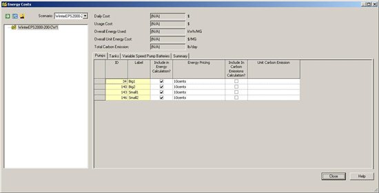

The ability to calculate the energy costs for operating a pump station, rather than just the individual pumps, has been included in WaterGEMS and WaterCAD V8i SELECTSeries 3. Please review the Carbon Emission and Energy Cost TechNote for more information.
This is a new feature added to the existing Energy Cost analysis. After entering a carbon dioxide emission factor, you can use the Energy Cost tool to help determine the total carbon emissions produced during the pump operation. Please review the Carbon Emission and Energy Cost TechNote for more information.

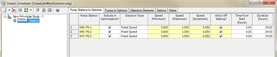

Darwin Scheduler in an earlier release of WaterGEMS and WaterCAD. This tool uses a genetic algorithm to optimize pumps and pump stations in a WaterGEMS model. Previous versions of Darwin Scheduler optimized only the individual pumps in a model.
Darwin Scheduler has been updated to include the optimization of pump stations. This is particularly useful in cases where a pump station contains a number of pumps that operate on the same pump curves. A tab was added to Darwin Scheduler to allow a user to select and optimize pump stations (Pump Stations to Optimize). This allows for Scheduler to simply determine the number of pumps that should be running, rather than which pumps are running. This allows Darwin Scheduler to test more possible solutions and allows for improved results. For this reason, it is generally recommended that the optimization is conducted on pump stations instead of individual pumps when possible.
Please review the Darwin Scheduler TechNote for more information on using this tool. Note that Darwin Scheduler is included with WaterGEMS and available as an add-on to a WaterCAD license.

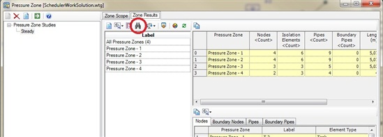

The Pressure Zone manager was introduced in an earlier release of WaterGEMS and WaterCAD. This tools allows you to determine which elements are in a given pressure zone in a model. After creating the zones for your model based on the boundary elements and selecting a representative element, you can compute the Pressure Zone study to find how many elements are in a given pressure zone. This data can also be exported out to your Physical alternative.
WaterGEMS and WaterCAD V8i SELECTSeries 3 introduced a “Find Pressure Zone for Element” function that allows you to identify which pressure zone a given element is found. After computing the Pressure Zone study, click the “Find Pressure Zone for Element” icon in the Pressure Zone manager under the Zone Results tab. This opens the Select tool bar. Choose the element in the drawing. The Pressure Zone manager will return with one of the pressure zones highlight, indicating the pressure zone that the element is located in.
