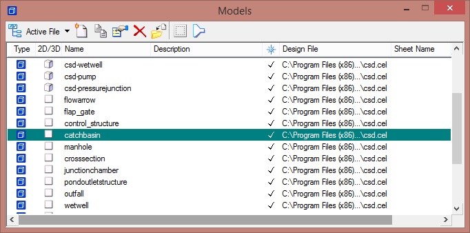

How can I set up StormCAD (or one of the other OpenFlows | Hydraulics and Hydrology products listed above) to draw custom cells for manholes, catch basins, pipes, etc., instead of the ones used by default (square for catch basins and circles for manholes)?
Problem ID#: 86372
Full element symbol editing functionality is available through the use of custom cells inside MicroStation. All elements and graphical decorations (flow arrows, control indicators, etc.) are contained within a .CEL file. For example Stm.cel for StormCAD.
To do this open the stm.cel file that's in the install directory (C:\Program Files (x86)\Bentley\StormCAD8 for StormCAD) then from the File menu, pick Models.
From here, you can select each of the Hydraulics and Hydrology products' symbols and change them using normal MicroStation commands. For instance, if you wanted to change the symbol for the catch basin, select "catchbasin" from the list. The catch basin will display and you can create or import a new symbol to use (if 3D symbology is available, it will be prefaced by the product name, such "csd" for CivilStorm.
Once you have adjusted the symbol and save the .CEL file, it will be available for new DGN files. You will be able to lay out new elements, or import an existing drawing into the new DGN file. The new symbols will be used.
