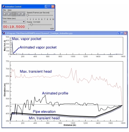

The Transient Results Viewer displays transient results in graph form. It can also animate hydraulic grade in a profile.
The "Paths (Profiles)" pulldown at the top allows you to select a profile (defined in the main user interface under View > Profiles) and then either plot or animate it. The "Plot" will provide the minimum and maximum transient envelope. The "Animate" button will allow you to see the hydraulic grade profile as it changes over time. This is useful in understanding how certain transient inducing events affect the system as a whole. If the Animate button is grayed out, make sure "Generate Animate Data" is set to "True" in your Transient Calculation Options. To reduce the amount of profiles available, go to View > Profiles, right-click on the ones you would like to omit from the Transient Results Viewer and deselect "Transient Report Path".
The "Time Histories" pulldown at the bottom of the Transient Results Viewer displays end points that are available to graph. The number of endpoints listed are determined by the "Report Points" option in the Transient Calculation Options. Note that transient simulation results are available at the ends of the pipes where they meet a node element. For example, the upstream side of a pipe or the downstream side of a pump. For time histories, you can plot the head, pressure, flow, air/vapor volume, and force (if you've chosen to compute transient force.)
In general, you can right-click on the frame/axis of the plotted profile, select "Format Data" and see the names of the various plotted lines in the dropdown.
For an animated profile, check the below diagram:
For a plotted head envelope:
Solid black line - Physical elevations
Dashed black line (or solid orange line if a pressure plot) - Initial conditions head
Solid red line - Maximum transient head
Dashed blue line - Minimum transient head
Red line at top - Max vapor/air volume
Dashed yellow line - Vapor pressure (as a reference)
