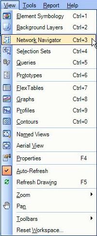

The selection tools can be accessed by clicking the View menu. The three selection tools are grouped together as shown on the tabs in the following screenshot:

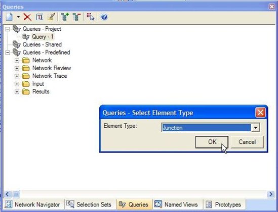

To start, click View --> Network Navigator. In the Network Navigator window, click the Queries tab. In the Queries window, right-click the Queries - Project folder and select New --> Query. In the Queries - Select Element Type window, choose "Junction" and click OK. The result is illustrated below:

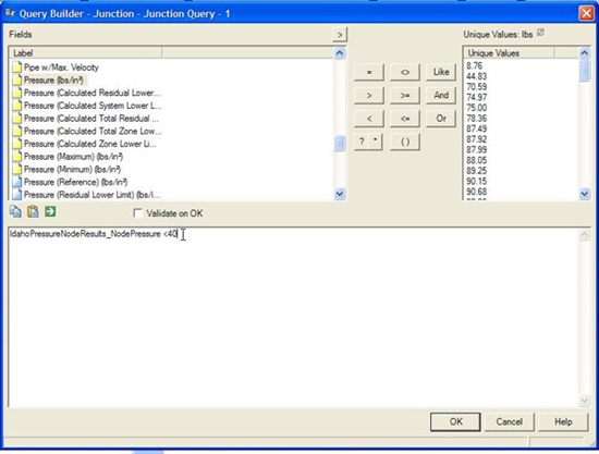

The Query Builder window opens. The Query builder is a utility that writes simple logical code in the bottom space using fields, math symbols, and unique values. Select "Pressure (lbs/in²)", click the < symbol, and then click "Unique Values" (next to the Unique Values heading) to initialize the pressure values present in the model. Manually enter 40 for the pressure value, as shown.

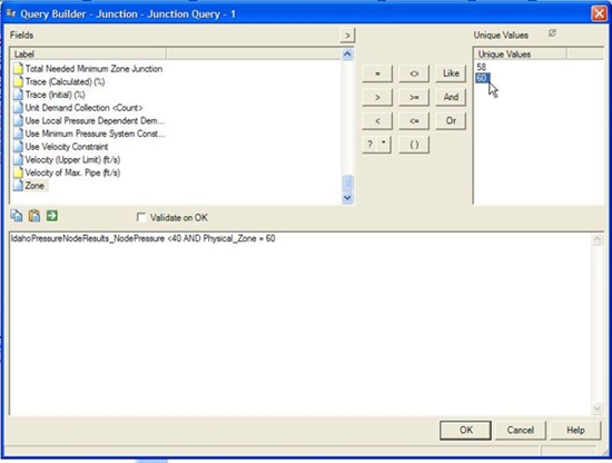

Now, to create a compound statement, go back to the Fields and "click "And," followed by the field "Zone," the "=" symbol. Again, click "Unique Values" to view the Zones available. Choose Zone "60" from the Unique Values list. This creates the compound query depicted below.

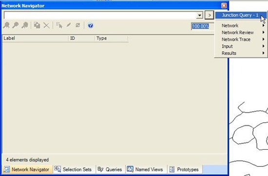

To utilize the unique query we have created, go back to the Network Navigator tab and choose "Junction Query - 1" using the ">" arrow to the right of the selection pulldown as shown.
The query shows that one junction falls within the compound logical statement created in the query window. The engineer can now recognize that there is one low pressure junction in zone 60. If other elements with a pressure of less than 40 psi were present, they would also appear in the list.

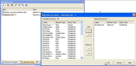

The Selection Sets tool is another method to create sets that can be used in the Network Navigator. You can create a selection set by choosing elements that have been picked manually or by using one or more predefined or user-defined queries, as shown below:
Once a selection set has been defined, you can use it in conjunction with color coding, element editing, special annotation, and other functions.
