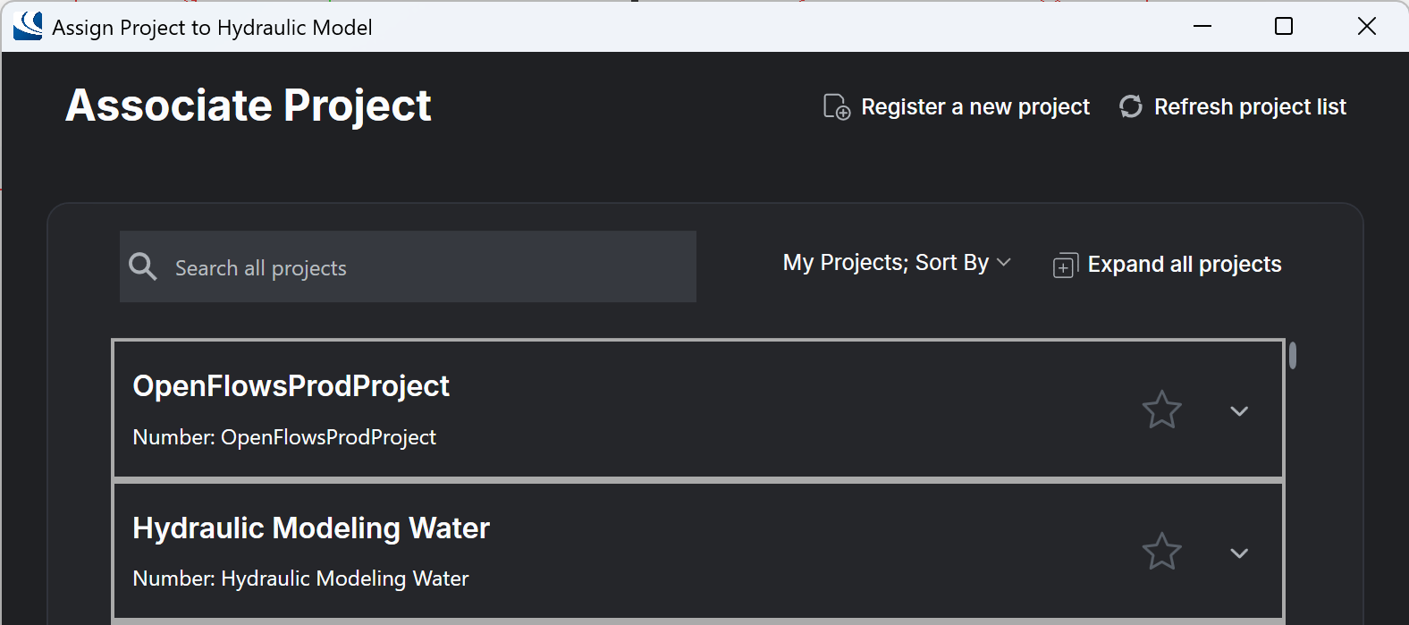

- The Assign Project to Hydraulic Model dialog will appear.

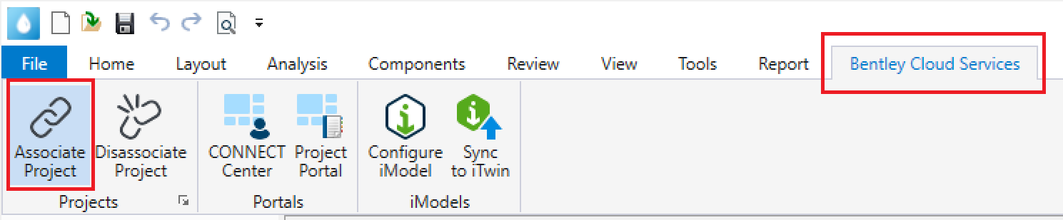

Note: This dialog can also be accessed by opening the Bentley Cloud Services menu and selecting Associate Project.
To Associate a CONNECTED Project to a Hydraulic Model
- In the Associate Project to Hydraulic Model dialog, select the desired CONNECTED Project from the list.
- Click Assign.
- The project name will display on the status bar to the left of your CONNECT user icon.
Note: Double clicking on the project name will also associate the project to the Hydraulic model.

- Open the Bentley Cloud Services menu and selecting Disassociate Project.
- The project name will no longer display on the status bar.
