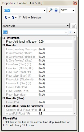

Users can find the property they want quickly in the property grid using keyword search. To use this function, open the property grid for any element, by either double-clicking on the element or going to View > Properties. The new Property Search field is above the list of element properties. Simply start typing the word you are searching for and the property grid will dynamically filter to show any property field name that contains the phrase entered.
Recent searches are stored in the drop down selection. The search term is maintained even when selecting a different element or element type. To clear the selection, click the Clear button beside the drop down.

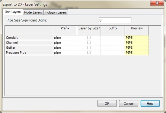

StormCAD now offers more control over layer/level assignment during DXF export. When you use the Export command, you first specify the drive, directory, and file name of the DXF file to be saved. Then the Export to DXF Layer Settings window opens, allowing you specify the names of the DXF layers on a per-element type basis.
The Export to DXF Layer Settings dialog is divided into tabs for Link Layers, Node Layers, and Polygon Layers.
Each tab contains a table that allows you to specify a prefix and suffix for the associated DXF layer. The Preview field displays how the label will appear.
Note that specifying a prefix or suffix also creates new layers for each prefix/suffix. If no prefix or suffix is specified all links, nodes, and polygons will be exported to the same DXF layer.
The Link Layers tab has additional controls: Entering a value in the Pipe Size Significant Digits field allows you to organize the pipe layer into multiple layers taking the pipe sizes into account using the Layer by Pipe Size checkbox.

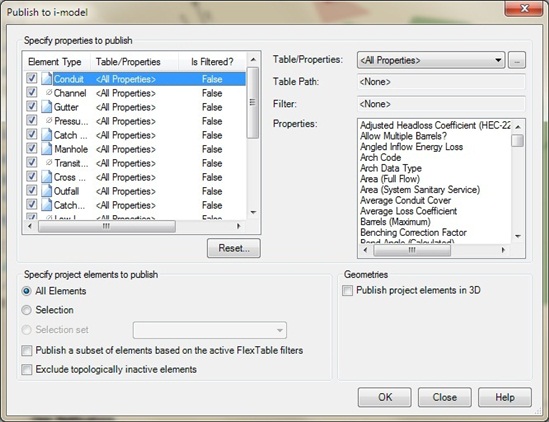

With the SELECTseries 3 release of StormCAD V8i, you can now publish an i-model. An i-model is an immutable container for rich multi-discipline information published from known sources in a known state at a known time. Basically it is a portable, read-only copy of a model file that can be viewed by users that do not have StormCAD. The topology as well as the attributes and results (for a particular timestep) can be viewed in MicroStation, ProjectWise Navigator, and Bentley View. Since Bentley View is free, i-models provide a way for anyone to easily view data and results for a StormCAD model file.
Under File > Export, you will have a "Publish i-model" option, which requires the i-model publishing engine (downloadable from Bentley SELECTservices). The i-model publishing engine shows as a prerequisite on the download page for StormCAD, but is only necessary if you intend to publish i-models. If you have no need to publish i-models, you do not need to download and install this optional component.

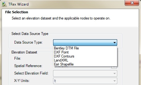

In addition to previously supported file formats, the TRex tool in StormCAD now supports the Bentley DTM file format. This is available through the Data Source Type pulldown.

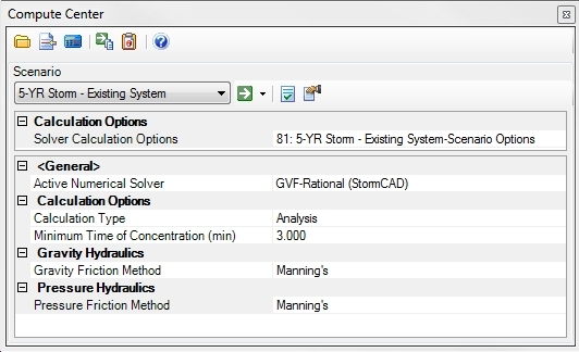

Users can now perform all actions related to model runs through one common location using the Compute Center. This streamlines the process modeling process of changing frequently used calculation options properties, including creating new calculation options. These functions are still available in the Calculations Options properties though.
The Compute Center is docked to the lower left of the drawing pane by default, and is accessible through the Analysis pulldown.

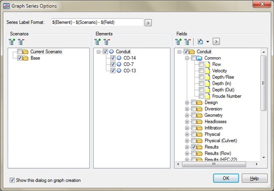

Also, StormCAD offers a new category of common graph properties for each element type to enable the user to quickly find and use the most commonly graphed properties.

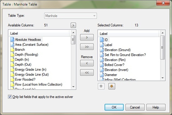

Flextable field display now has handling for multiple solvers, as not all fields are used for all solvers. Users can now choose to display fields specific to the active numerical solver (default setting) or all fields available in the product.
