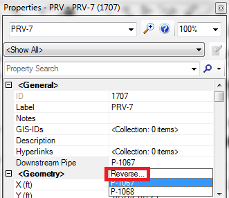

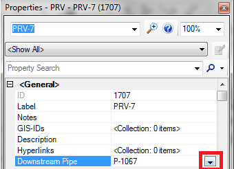

1) Under the general section for the property labeled "Downstream Pipe" click the drop down arrow next to the pipe label
2)  Click the "Reverse..." option.
