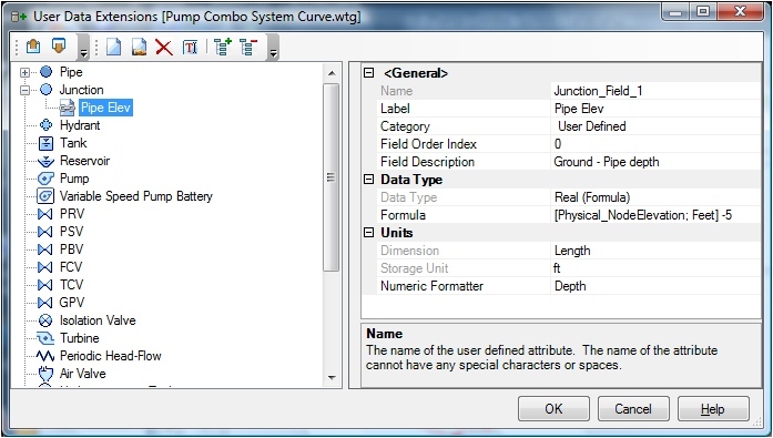

- Formula-based User Data Extensions

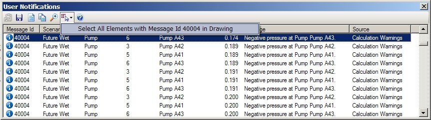

- Selection Tool for User Notifications

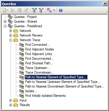

- New Network Tracing Queries

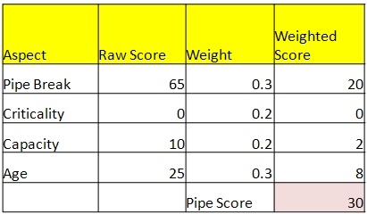

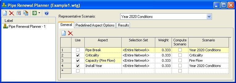

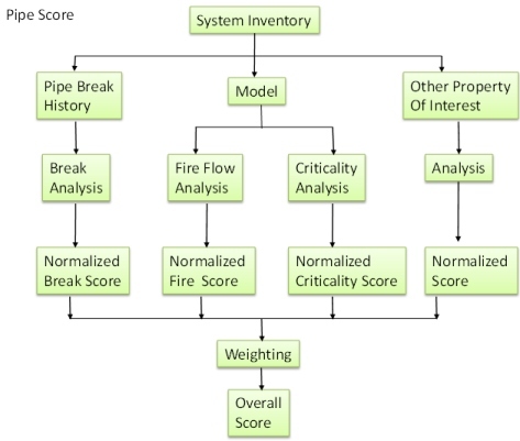

The Pipe Renewal Planner is a powerful new condition assessment tool, enabling you to score and rank existing water mains based on their adequacy in terms of a number of performance indicators called "aspects", which are not in the same units. The default aspects that the pipe renewal planner primarily considers are Pipe break history, capacity (fire flow) and criticality (demand shortfall when pipe is out of service). You can also consider any other aspect of the model, including calculated model results or user-entered field (such as installation year, zone, material, etc).
For a given aspect, each pipe is given a normalized score on a 0-100 scale. Each aspect is then given a weight, and an overall score is generated for each pipe.
The overall process for determining the "Pipe Score", which is the final result of this analysis, is:
Note: Similar to Darwin Calibrator, Darwin Designer, Darwin Scheduler and Skelebrator, the Pipe Renewal Planner feature uses a separate license, which should show up in your license management tool.

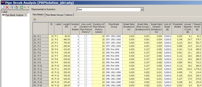

The Pipe Break Analysis tool is a new feature that allows you to import and analyze historical data on pipe breaks. The results of this analysis can be viewed on their own or used as part of the Pipe Renewal Planner tool to determine the overall condition score of a pipe. A projected break rate (breaks per year per mile) is calculated for each pipe, along with other results such as annual expected cost.
The overall steps in conducting a pipe break analysis consists of:
For more detailed information, check the Running Pipe Break Analysis TechNote

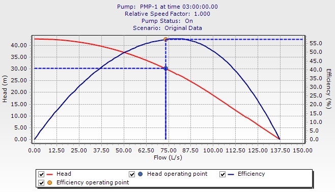

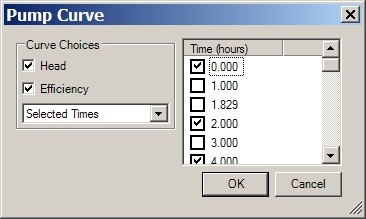

In previous versions, the pump curve viewer (right click on a pump and choose "pump curve") only displayed the head curve, for the current time step. The pump curve display has been improved in V8i SELECTseries 2 and you now have the ability to:
Example 1: Current time with head and efficiency:
Example 2: head and efficiency at multiple times with different speeds:

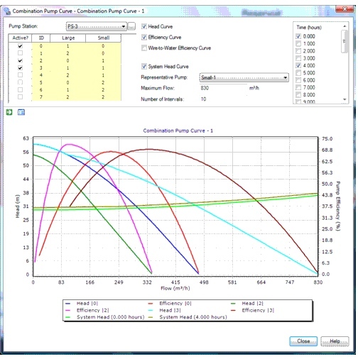

The SELECTseries 2 release of WaterCAD/GEMS V8i introduces a new element type called a pump station, which is used in a new tool called Combination Pump Curves.
A pump station is a polygon element used to model multiple pumps that are in the same structure, serving the same pressure zone. It provides a graphical way to display the pumps associated with the station. A pump station is not a hydraulic element in that it is not directly used in a hydraulic analysis but rather it contains a list of pumps that are within the "station".
A pump station displays which pumps are in the station by dashed lines connecting the pumps with the station polygon centroid. A pump does not need to be inside the polygon to be a pump assigned to the station and pumps inside the polygon still need to be assigned to the station. Select the pump station from the "Pump Station" attribute of each individual pump.
Once the pump station has been established, you can perform a pump combination analysis, either by right clicking the pump station and choosing "combination pump curve" or by going to Analysis > Combination Pump Curves. Multiple combination pump curves can be created and saved, similar to the system head curve manager.
Combination Pump Curves allow you to view the performance of multiple pumps running together in parallel in a pump station. The system head curve can optionally be displayed, at multiple times. The example below shows three different combinations for two time steps (system head curves).
The "active?" column allows you to choose from all possible combinations of pumps (which ones are on or off). The "ID" is used to identify the particular combination in the legend. The number in the cell indicates the number of pumps of that pump definition that are running for the combination corresponding to that row. If there is a zero in a cell, the pump is off for that combination.

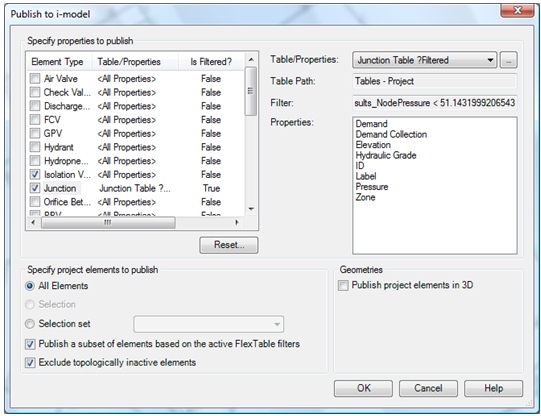

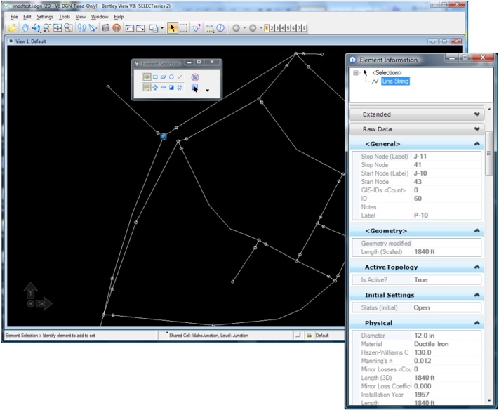

With the SELECTseries 2 release of WaterCAD and WaterGEMS V8i, you can now publish an i-model. An i-model is an immutable container for rich multi-discipline information published from known sources in a known state at a known time. Basically it is a portable, read-only copy of a model file that can be viewed by users that do not have WaterCAD/GEMS. The topology as well as the attributes and results (for a particular timestep) can be viewed in MicroStation, ProjectWise Navigator and Bentley View. Since Bentley View is free, i-models provide a way for anyone to easily view data and results for a WaterCAD/GEMS model file.
Under File > Export, you will have a "publish i-model" option, which requires the i-model publishing engine (downloadable from selectservices.bentley.com). The i-model publishing engine shows as a prerequisite on the download page for WaterCAD/GEMS, but is only necessary if you intend to publish i-models. If you have no need to publish i-models, you do not need to download and install this optional component.

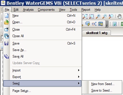

Seed files allow you to save project settings and data as a template (the seed file has a .wgs extension). You can then reuse these settings/data while creating new projects using the data from the previously saved seed file.

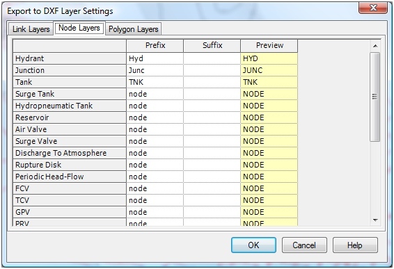

When exporting the plan view of a drawing to a DXF file, different elements can be placed on different layers.

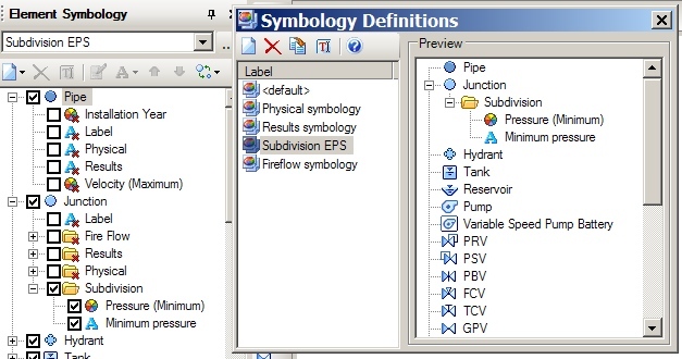

You will now have a dropdown at the top of the Element Symbology manager, which allows you to configure which symbology should be applied. For example, you could have one symbology definition for steady state with certain annotations and color coding enabled, then another one for EPS, with different annotations and color coding enabled.

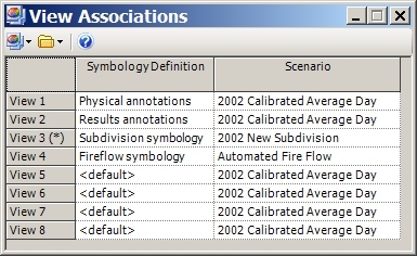

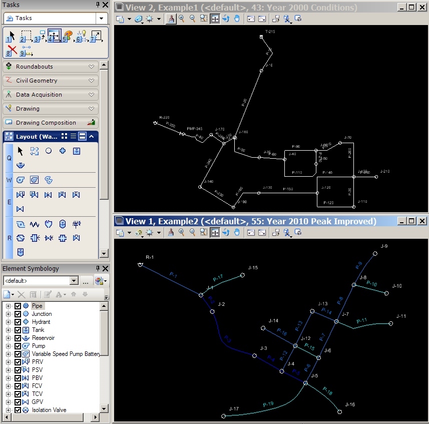

When working in the MicroStation integrated mode, it is now possible to associate scenarios and symbology definitions with MicroStation Views. This basically lets you see different scenarios and/or symbology definitions (color coding/annotation at the same time, by opening multiple MicroStation Views.
A "mode" button is available for both Element Symbology and Scenarios:
Example:

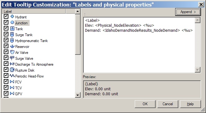

While using the Microstation integrated mode, the new tooltip customization feature allows you to define custom text to appear when hovering the mouse over an element in the drawing. You can enter static text and/or dynamic annotations, similar to element symbology annotations. This can be a convenient alternative or supplement to annotations, as you can quickly view data just for the element you point to.
Note: be sure to right click on the tooltip customization and choose "make active".

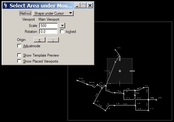

Print Preparation is a special tool that was not readily available in previous versions. It is now included with the installation of WaterCAD/GEMS, making it easier for you to print your model when using the Microstation integrated mode. It can be accessed from the bottom of the Tasks list:
Print preparation is essentially a printing wizard; first you select a template, then follow the prompts, selecting the area of the drawing and rotation for the main viewport and detail views. Several templates are included with WaterCAD/GEMS: ANSI, ARCH and ISO:

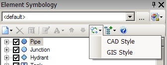

You can now choose between CAD (zoom dependent) or GIS (zoom independent) drawing style when working in MicroStation. With GIS style, symbol and text sizes stay the same, regardless of your zoom level.

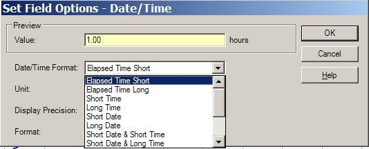

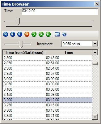

In previous versions, time was often displayed in a fixed way, and in some cases was not consistent. for example, the calculation summary displayed as 03:00:00 whereas data tables displayed as 3.00. In V8i SELECTseries 2, you can now customize the time format.
In the past, a user data extension always contained static, user-entered information. Now, you can create a user data extension whose value is calculated based on other existing fields. For example, you can create a field whose value is equal to the square root of the difference between one input field and another user data extension. The possibilities are endless. In the below example, a field has been created for pipe elevation, whose value is equal to the junction ground elevation minus 5 feet.

Three new network tracing queries have been added:
