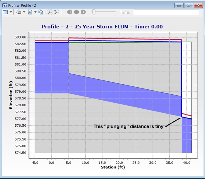

I'm getting flooding at an inlet, but when I run as a culvert, no flooding.  Why? In my StormCAD model, a single lateral conduit has an incredible exit loss at a manhole connection.
Explanation
  1. This is a rare, known limitation with our current implementation of the HEC-22 3rd edition structure loss method. This can occur in a specific condition where the downstream node is using the 3rd edition structure loss method and is considered "plunging", but the plunging depth is very small (difference between the upstream pipe's outgoing invert and the structure's HGL). The velocity used in the exit loss calculation is based on the area created by this difference along with the respective flow. So, you can see that with a very small plunging depth, the velocity used is very high, leading to a high exit loss.
  2. To illustrate further, in the case with the manhole, you can set the "bolted" option for this manhole to "false". This causes the HGL to be effectively "capped" at the rim, allowing you to see more clearly the small plunging depth mentioned above (the manhole in question is on the right side)
  3. The conduit/manhole situation being very close to non-plunging makes the model sensitive.  For example when you lower the invert of the node by enough of a distance so that the upstream pipe's stop invert is above the node's HGL, it is enough to cause a non-plunging condition.
