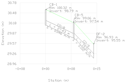

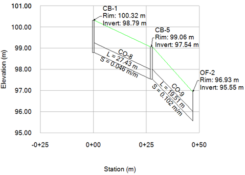

When an engineering profile is viewed in the standalone platform the axis scale values are correct.
When the engineering profile is exported to DXF the axis scale values are incorrect.
Note: This only happens when SI units are used.
Contact technical support for the latest patch, or upgrade to a newer version when available.
