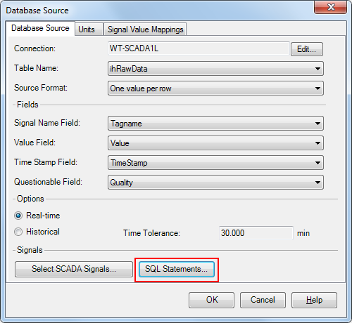

The database connections in SCADAConnect support editing the SQL Statements by way of the SQL Statements… button at the bottom of the Database Source dialog. If you click this button you will be presented with a set of default queries that are based on the settings you have selected for Source Format and also whether the data source is real-time or historical.

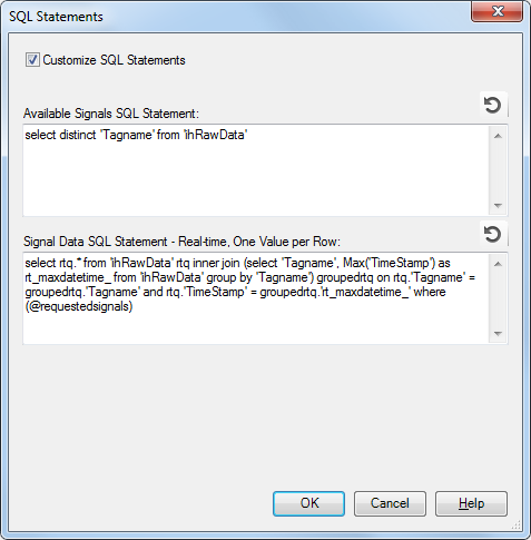

If you click on the Customize SQL Statements check box, the default queries become editable. The following image shows the default custom queries for a real-time data source with a source format of one value per row.
As you can see, the default query for creating the list of signals or tags is straightforward and may be suitable often, however, the second SQL statement is more complicated. Each of the different kinds of SQL statements are covered below in more detail.

Signal Data SQL Statement - Real-time, One Value per Row
(Applies to Real-time, One value per row).
select rtq.* from ['table_name'] rtq inner join (select [signal_name], Max([DateTime]) as rt_maxdatetime_ from ['table_name'] group by [signal_name]) groupedrtq on rtq.[signal_name] = groupedrtq.[signal_name] and rtq.[DateTime] = groupedrtq.[rt_maxdatetime_] where rtq.[signal_name] in (@rtq.requestedsignals)
The default statement appears to be somewhat complex. Most of the complexity is the direct result of needing to keep the statement generic and applicable to the widest number of systems. This query employs an SQL alias (rtq; i.e., real time query) coupled with an SQL inner join to find the value for each signal/tagname with the most recent time stamp. A table/view with a column for signal/tag name, value, timestamp and quality should be answered by the query.
The signal/tag names used in the query are derived from the @requestedsignals variable.

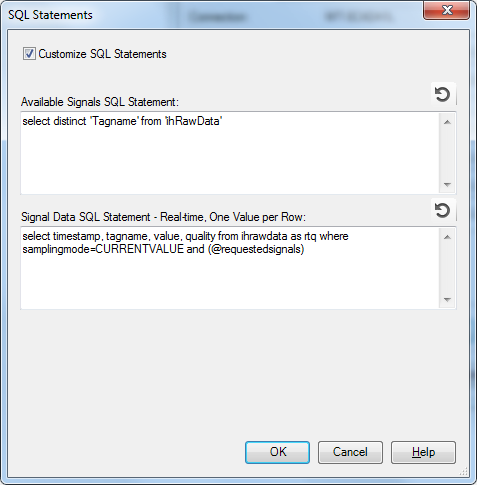

The GE Proficy Historian is one good example of case #3. As mentioned earlier, the default Signal Data SQL Statement does not work with this database; however, the database provides a more efficient way of retrieving real-time data. We'll use this specific example to illustrate how to edit custom queries.
How to edit the real-time queries
To edit the SQL queries you simply have to type into the available boxes. It is recommended that someone with database.SQL experience does this, though it is possible to reset to the default query at any time by clicking the reset button for each query (top right of the query text box), or turn of the use of customized queries by unchecking the Customize SQL Statements check box.
Using some customized SQL queries for GE Proficy Historian as an example, the query for Signal Data SQL Statement has been modified as shown.
The portion of the SQL statement samplingmode=CURRENTVALUE tells the GE Historian database to fetch the latest value for the particular field/tagname. This replaces all the extra SQL that was devoted in the default query to execute the inner join and is the preferred way for the GE Historian database.
Note: The image above shows as part of the signal data query the words "as rtq". This is a requirement in earlier versions of SCADAConnect due to a quirk present in those versions. The quirk is related to the default SQL statement, that we have already examined above, which uses the rtq alias in the SQL statement that defines the inner join. Thus, SCADAConnect is expecting to see that alias in use for the table where the signal name(s) (tag name(s)) are present. The result of the quirk is that in the initial CONNECT releases of the Bentley OpenFlows products, the "as rtq" part of the customized statement is necessary to include for the custom query to work correctly. In the latest product versions, however, the custom real-time query does not require the inclusion of the rtq alias (via "as rtq"), though any custom queries that do include the "as rtq" alias will still work.
