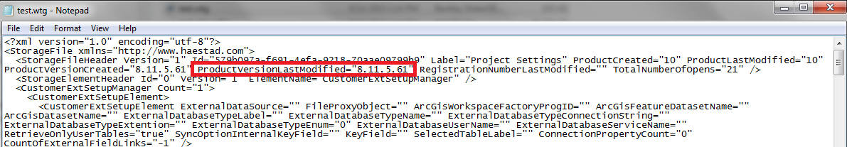

The exact version number that a model was last saved in is identified inside the main model file. Locate the file for your particular product per the below list and open it (right click > open with) in a text editor like NotePad, NotePad ++, Wordpad, or another other simple text editing software. These files are simply .xml files, so you can open them in a text editor. On the third line of text, the build number will be shown after "ProductVersionLastModified=".
