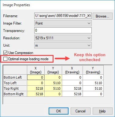

1. Select the image file (with Hebrew filename) to load as a background layer
2. When loading the image, uncheck the "Optimal image loading mode" to avoid the memory issue.
This can also help for particularly heavy images used as background files.
