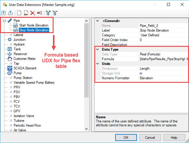

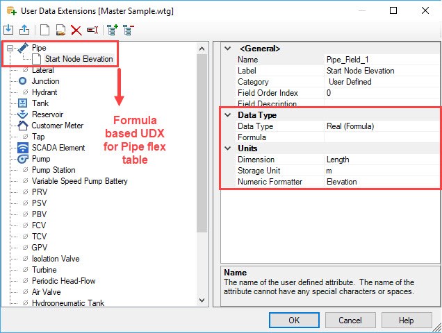

1. Define a formula based User Data Extension (UDX) for Start Node Elevation. Keep the Data Type as "Real (Formula)" Dimension as "Length", Storage Unit as per your unit system (m, ft etc.) and Numeric Formatter as "Elevation".

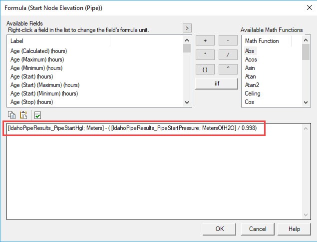

2. In the Formula use this formula "Hydraulic Grade (Start) – [Pressure (Start) / 0.998]". It would look like this;
In the above formula we have divided the pressure with specific gravity of water (0.998) because pressure = pressure head * 0.998
“Pressure Head” is a property which is restricted to a junction. Since it is not directly available in the pipe flex table we have used “Pressure” and converted it to “Pressure Head” as shown above.

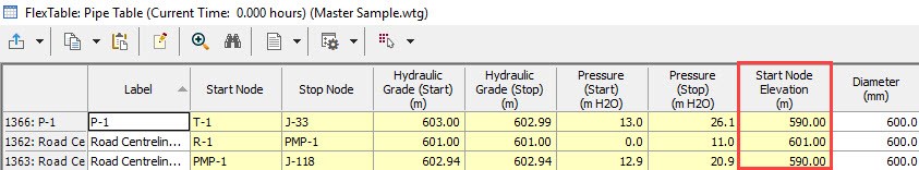

3. Now add the newly created field “Start Node Elevation” as a column in the pipe flex table.
Use the “Edit” tool in the Pipe flex table to add the required field.

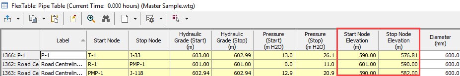

4. Similarly create a new formula based UDX for Stop Node Elevation. The formula in this case should be "Hydraulic Grade (Stop) – [Pressure (Stop) / 0.998]"
5. Add the “Stop Node Elevation” field in the pipe flex table.
This can help map these fields in the pipe flex table for reference. A good practice in this exercise would be to keep the same display precision for both the fields. If your elevations are entered with some fixed display precision (say 2) then keep the same display precision for “Hydraulic Grade” and “Pressure”. This way the accuracy of formula would be maintained.
