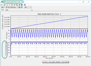

With WQBR you can view results such as graphs, for the concentration of each constituent, volume of water from each trace source, etc. You can also view tabular reports of results and export for color coding.

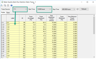

The above tabular results are for trace analysis which shows trace results at each time step for all elements in the model. In trace analysis you can choose between multiple sources of trace and then check the trace percentage for all elements in statistics table by changing trace source.

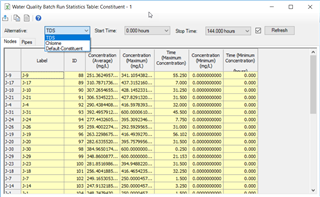

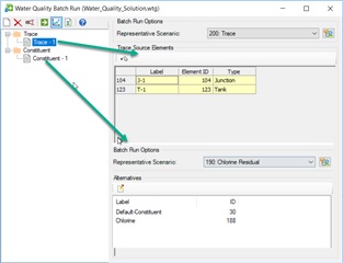

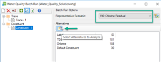

To perform batch run of constituents along with trace, you can select multiple constituents from alternatives as shown below and then see the concentration of each for selected elements. For this first you need to setup respective alternatives for the constituents and select those alternatives and respective scenario in water quality batch run window.
To view the graphs you need to select elements from drawing for which you want to see results in graphical format and in statistics format, results for elements are shown.

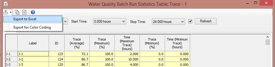

Aside from the graphing and statistical table above, starting with the CONNECT Edition Update 2 release of WaterGEMS and WaterCAD, you can now export the maximum, minimum, and average results for a trace or constituent analysis to an Excel spreadsheet or to user data extensions for use with color coding:
Export to Excel: In the Statistics table, click the Export button in the upper left and choose Export to Excel. The data for different source types will be exported to individual worksheets in an Excel file. For instance, if you have three different Trace sources in your Water Quality Batch Run, you will see three worksheets in the Excel file, one for each source. Each worksheet will display the nodes in the model, as well as the maximum, minimum, and average results for the study.
Export for Color Coding: In the Statistics Table export button, the "export for color coding" will create user data extensions (fields in the element properties) with statistical results for the values for the selected source. For example minimum, maximum and/or average. With this, you can perform color coding on the min/max/average field.
