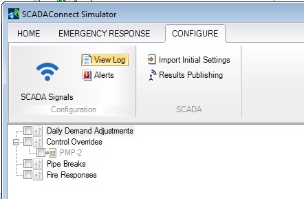

In version 08.11.06.58 and higher (including CONNECT Edition, 2023, 2024, etc) the SCADAConnect log file is available from the Configure Ribbon:
Note: starting with Patch01 of version 10.02.01.06, the log file is located here: C:\Users\<User Name>\AppData\Local\Bentley\SCADAConnect\10*\SCADAConnect.log
*Product version (10, 24, 26...)
