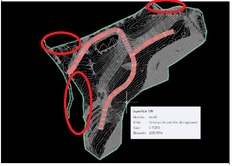

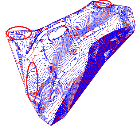

When using a LandXML file in the Terrain Model tool, the boundary lines are not respected. Contour lines are shown beyond the boundary lines. For example:
As seen in Civil 3d, as an example:
As seen as a Terrain Model layer in SewerGEMS, CivilStorm or StormCAD:
Most likely the LandXML file does not have a formal Boundary specified. Open the file in a text editor such as Wordpad. Within the section "<SourceData></SourceData>", a "</Boundary>" should be defined. If it is not, then the file is essentially just points and faces, with no formal boundary data to constrain a triangulated version of the terrain model, which the Terrain Model feature needs to process.
Software such as AutoCAD Civil3D is OK with just reading in the faces, but Bentley products (and other civil products also) have to run the points through our own triangulation routines to create a triangulated mesh for the terrain, and therefore we need more information in the SourceData section, such as boundary data, to tell the program where to exclude triangles that can be drawn at the given points.
So, the solution is to define a Boundary in your LandXML file. If you're using Civil 3D and are unsure of how to do this, please contact Autodesk.
