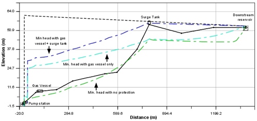

Combine, save and export profiles and graphs from the HAMMER transient results viewer
