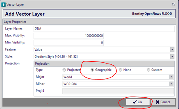

The applied DTM cannot be seen in the Map of Bentley® OpenFlows FLOOD
This issue can occur when you don’t have the latest video card driver version, or the settings are not correct.
Please try the following:
- The DTM file has embedded information about its coordinate system (e.g. geographical coordinates WGS84) so you will need to change the projection and only load and press OK when the projection dialog appears.
- Try adding the DTM and then the web map and also the other way around i.e. adding the web map first and then the DTM file.
- Create a copy of the DTM file
- Open the copy of the DTM file in notepad and delete the first line (with the PROJ4_STRING keyword).
- Save the file and load the copy to in Bentley® OpenFlows FLOOD.
- Then load/add the web map.
