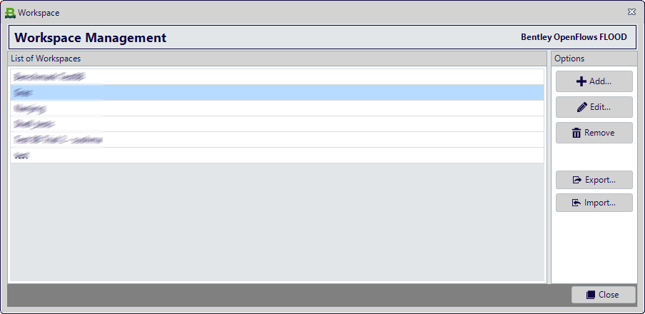

We will import an existing workspace to OpenFlows FLOOD database, and to do that proceed as following:
Figure 1 – Workspace Management dialog menu (importing an existing workspace)
Now if you click on “Manage” (inside “Workspace” group) you should be able to see the imported workspace in the List of Workspaces.
NOTE: If a workspace with the same name of the workspace to import already exists, the newly imported workspace is automatically renamed (example: Graz_1).

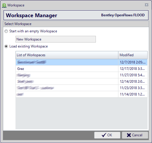

Finally, we must open the imported Workspace:
Figure 2 – Workspace manager (loading existing workspace)

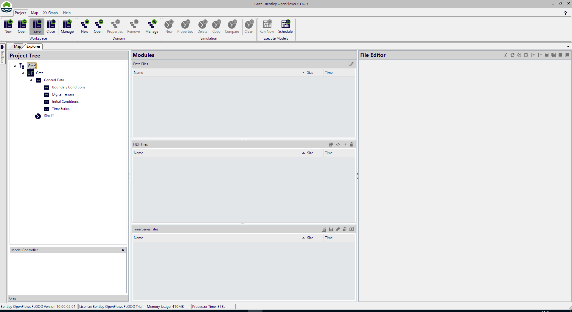

This action will also load the model project to the Project’s “Explorer” tab.
Press on the triangles () to expand the tree view in the “Explorer”. Your screen should now look like shown in the next figure.
Figure 3 – Explorer tab - overview
