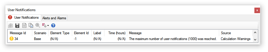

User Notification: "The maximum number of user notifications (1000) was reached."
Product(s): WaterGEMS, WaterCAD, HAMMER, SewerGEMS, SewerCAD, StormCAD, CivilStorm, PondPack
Version(s): 08.11.XX.XX and 10.00.00.XX
Area: Output and Reporting
When computing a model a warning user notification appears stating:
How to display the user notifications that are not showing because of the 1000 message limitation.
It is best to try addressing some of the notifications first (some may be related to a single problem), then try again. Use the Validate command first before computing the model.

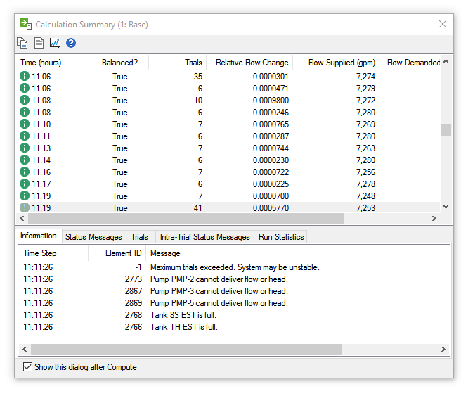

For WaterCAD, WaterGEMS and HAMMER, under Calculation Summary, click on each time step to see user notifications associated with that time step:

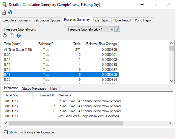

For SewerCAD (or the GVF-Convex solver in SewerGEMS), click the "Pressure Summary" tab of the calculation summary, select a pressure subnetwork, then click through the timesteps:
