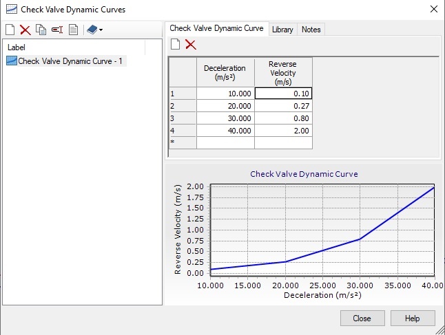

Starting with HAMMER CONNECT Edition Update 3 (build 10.03.03.72), it is possible to apply Check Valve Dynamic Curves (or reverse velocity vs deceleration curve) to a model. In the transient simulation, reverse velocity and deceleration at a time step can be calculated. The calculated values can be compared with Check Valve Dynamic Curve to determine when the check valve will close instantaneously.

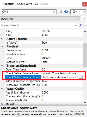

To use this feature, set the Check Valve Closure Type to “Dynamic Characteristics Curve.”
You can then select an item available in the Check Valve Dynamic Curve manager (Components > More > Check Valve Dynamic Curves). This manager will include the reverse velocity vs deceleration curve data for check valve used in the model.
During the transient simulation, reverse flow velocity and deceleration are calculated, then compared with reverse velocity and deceleration data in the check valve dynamic characteristics curve. If the calculated reverse velocity exceeds the reverse velocity in the curve at the calculated deceleration, the check valve will close instantaneously.

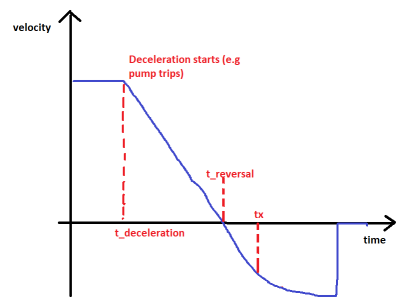

When using the dynamic check valve curve at a check valve node, HAMMER starts calculating deceleration when the flow velocity decreases (for example after a pump is shut down). When deceleration starts (velocity starts decreasing), HAMMER will calculate the average deceleration for all time steps but does not use them immediately. Starting from the first time step after flow becomes negative, HAMMER uses the calculated deceleration to determine the reverse velocity from the deceleration vs. reverse velocity table (from the check valve dynamic curve) using interpolation. The deceleration that it uses for this comparison is based on the average from the time when flow first starts decreasing until the flow is zero. Meaning, average deceleration is calculated across t_Deceleration to t_reversal in the figure below,.
When the reverse velocity value is larger than the interpolated reverse velocity value from “deceleration vs. reverse velocity” table using the calculated average deceleration (calculated from the time step when velocity starts going down to the current time step), the check valve will close instantly.
Secondary closure criteria: Additionally, if flow acceleration happens (reverse velocity value at one time step is smaller than the reverse velocity value from the last time step), the check valve will close instantly. Extensive checking has been done to confirm that this criteria is valid. There is not currently a way to disable this secondary criteria.
This secondary acceleration closure criteria is a simple way to use the check valve “deceleration vs. reverse velocity” curve to close the check valve and it has no conflict with the primary criteria. Average deceleration is calculated when flow is decelerated (velocity decreases, flow reverses and then reverse velocity keeps increasing). Once flow is accelerated (reverse velocity value decreases), it will recalculate average deceleration from the calculation time step when the reverse flow value decreases. At the calculation time step when flow is accelerated, the velocity value change is small (deceleration is small) and the target reverse velocity value from “deceleration vs. reverse velocity” curve is small. At the calculation time step when flow is accelerated, the reverse velocity value is large and it is larger than the target reverse velocity value from “deceleration vs. reverse velocity” curve. This will cause check valve to close. Even without using the acceleration criteria, the check valve will still close in one more time step when flow is accelerated. The acceleration criteria is simply an additional way to close the check valve using the “deceleration vs. reverse velocity” curve.
