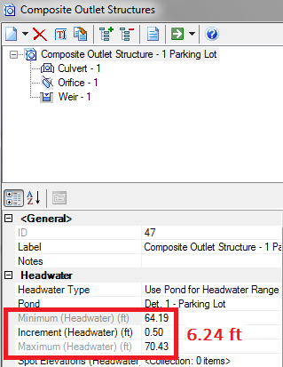

Confirm which outlet the problem refers to: For an outlet structure, this issue can happen when a component (such as an orifice, culvert, weir, or vortex valve) has elevations set that do not match up with the headwater elevation range used for the composite outlet structure itself (pond). This most often occurs with the composite outlet structure noted in the user notification itself, although it can sometimes be more general and be referring to a different composite outlet structure.
First, note the name of the outlet structure that is causing the issue in the list of User Notifications. Next, go to Components > Composite Outlet Structures and find the composite outlet structure associated with the outlet structure in the User Notification.

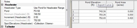

Next, review the elevations for the headwater range of the Composite Outlet Structure and make sure that they match up with the elevations of the pond associated with the Composite Outlet Structure.
If the outlet link element has "Use Elevation-Flow-Tailwater Table" set to "Yes", then check the selected EQT table to make sure the headwater range matches the upstream pond elevation range, and that the tailwater range matches the downstream pond's elevation range. For example, if the pond elevation is from 10 feet to 20 feet, then the headwater portion of the EQT table needs to range from 10 to 20 feet.
If using a composite outlet structure, the elevations for the Composite Outlet Structure may be outside of the range of the pond elevations, and will need to be resolved before the model will compute. This can happen for example if the wrong pond is selected in the "Pond" field of the headwater range, when the headwater type is set to "Use pond for headwater range".

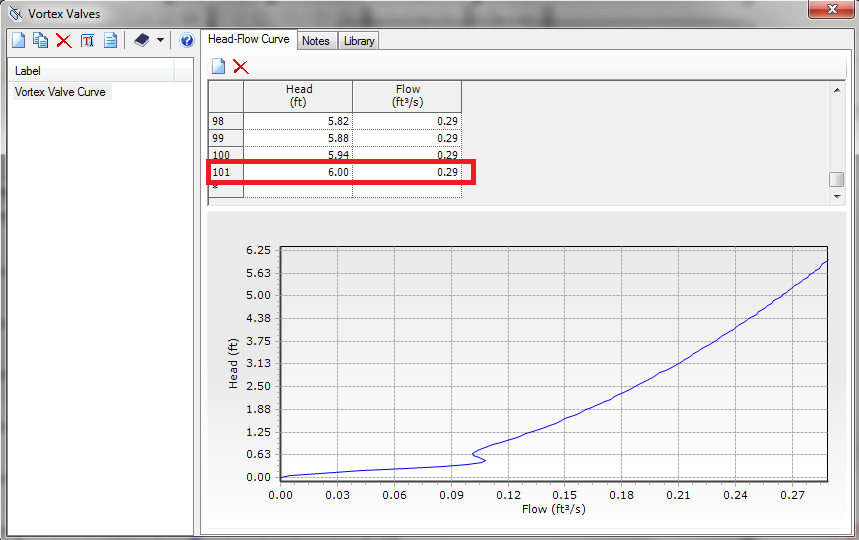

The maximum value on the vortex valve curve is 6 ft. at 0.29 cfs., but if you look in the screen shot below the total difference in headwater range is 6.24 ft., which is not covered by the curve. If you add in one valve of 6.24 ft. with a flow of about 0.30 cfs this problem would be resolved and the model would run.
