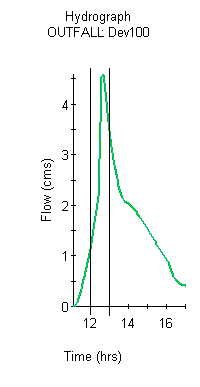

 This error message can usually be avoided by narrowing the timestep on the GO dialog in order to include an ordinate closer to the internally computed time peak.
For an illustration, see the graph below.  As you can see from the picture using a timestep of 1 hour would have taken readings at the two places marked.  The peak outflow occurs between those two places, and therefore there is not an interpolated peak at the true calculated peak.
