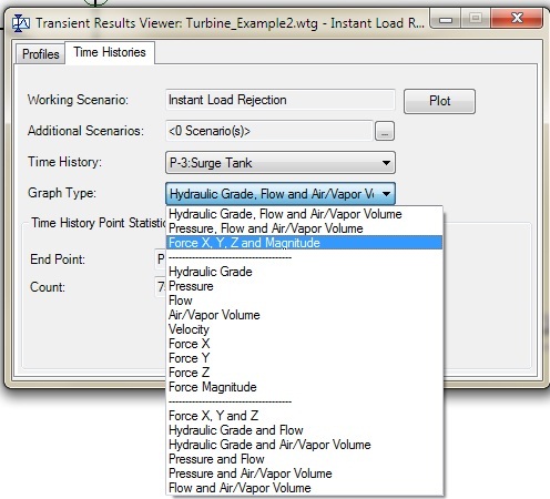

By default, HAMMER does not calculate force results, but you can set up the model to run these calculations. To do this, go to Analysis > Calculation Options and double-click the active Transient Calculation Option to view the properties. In the properties, find the attribute "Calculation Transient Force?" and set this to True.
Once this is done, compute the model.
There a couple of different ways to view the results. First, under the Time Histories tab of the Transient Results Viewer, you can choose "Force X", "Force Y", "Force Z" "Force Magnitude", or "Force X, Y, Z and Magnitude" as the "Graph type". Select the end point where you would like to see the force results, then click "Plot".
