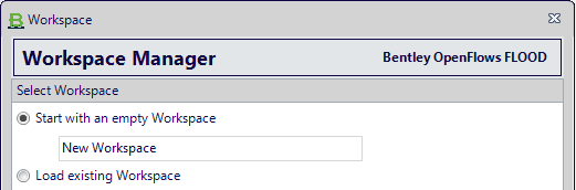

After this you will see a new dialog menu where you should use the default selected option:
Figure 2 – Create empty Workspace
You can click ok. After that, the tab will change to “Explorer” and you will be able to see the Project Tree with the name of the Workspace selected (in our case, the default Workspace name was used – “New Workspace”):

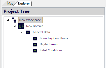

Now we have created the basic structure of the project (solution + domain). If you expand your Project Tree, Your Explorer tab should look like shown in the next figure.
Figure 6 – Visualizing Project Tree from the New Workspace and New Domain
