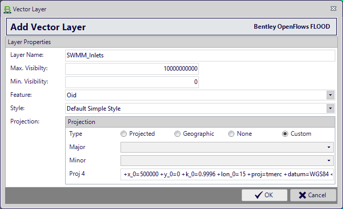

By default, any data layer that has no pre-defined coordinate system and projection will be added has “no projection”, and OpenFlows FLOOD will add it in the same coordinate system (and projection) as defined in the map. Thus, using coordinate systems or projections different from the map definition should be duly selected (if it’s available in OpenFlows FLOOD) or manually introduced with a customized projection (Proj4) string when you add the layer to the map, in order to convert the specific coordinate system to other types of coordinates.
For instance, the existing project shapefile with the inlets (street gutters) is projected in a different coordinate system (UTM WGS 1984; UTM Zone 33N). This shapefile has the geographic information already embedded in the shapefile, thus when you select it, OpenFlows FLOOD immediately pre-load a custom Proj4 string, which corresponds to the UTM WGS 1984; UTM Zone 33N definition, you can add this shapefile as follows:
Figure 2 – Add vector layer / custom string for projection
After selecting “OK”, you will be able to see the street gutters to be included in the model, with a default blue placemark:
