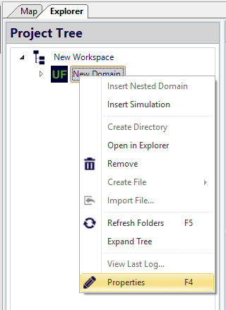

When you create a new workspace and model domain, but no topography file was associated, you can associate a topography file with the model domain.
To do so, please switch back to the Explorer Window, select the domain created (“New Domain”), right-click and choose “Properties”.
Figure 1 – Opening Domain Properties
