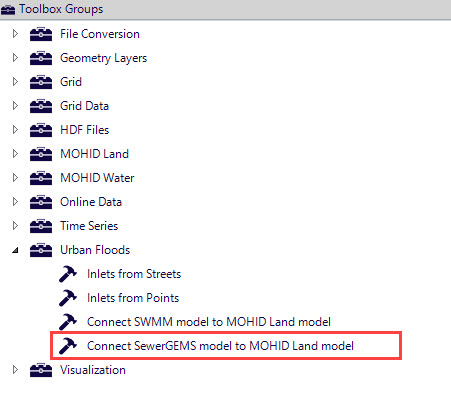

Connection with SewerGEMS models
With this release it is now possible to directly link existing SewerGEMS model files (.stsw) to integrate seamlessly with MOHID Land. This enables to create a link between the 1D SewerGEMS data with the 2D surface runoff data.
This tool can be accessed in the Toolbox Menu under Urban Floods (Toolbox > Urban Floods > Connect SewerGEMS model to MOHID Land model).
The integration is easily done by inputting the SewerGEMS model configuration file (.stsw file) and the MOHID Land (surface) digital terrain model. The tool then generates new output files (2 or 4 – in case channels exist in the SewerGEMS project) to be indexed in the FLOOD project configuration. This tool also includes additional options such as forcing the (SewerGEMS) node elevation to the (MOHID Land) DTM elevation (avoiding for instance manholes located below or above the ground).
Note: The earlier version of FLOOD only supports linking of a SewerGEMS model via a SWMM file (.inp format). However, this has been retained in this release also along with the option of directly linking a SewerGEMS model (.stsw format).
See this article for more details on this: Integrating SewerGEMS or CivilStorm with OpenFlows Flood for 2D simulations
Although the above option mentions connectivity of a SewerGEMS model with FLOOD, technically a model created in any of the four storm-sewer products viz. SewerCAD, StormCAD, CivilStorm and SewerGEMS can be used to link with FLOOD since the file type for all these products is the same (.stsw).

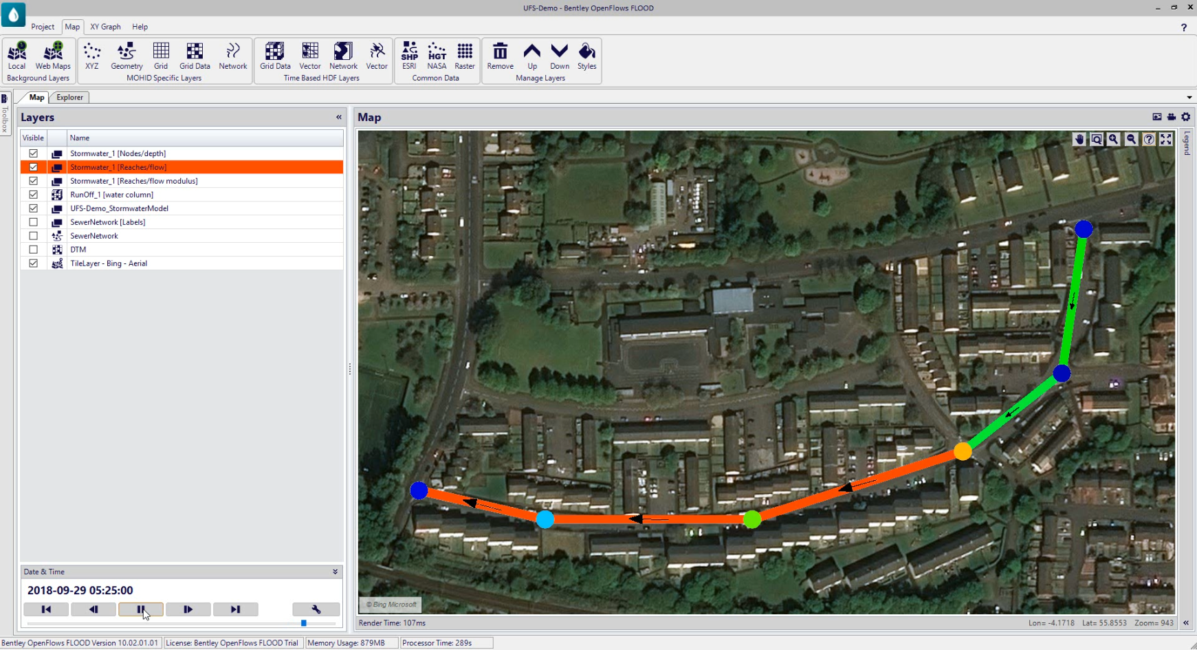

Map Visualization Improvements
With this new release there are improvements made in the way maps are visualized in FLOOD. You can now color code nodes, pipes and channels for a better visualization experience. You can also visualize flow and velocity vectors in pipes or channels in a better way.

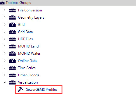

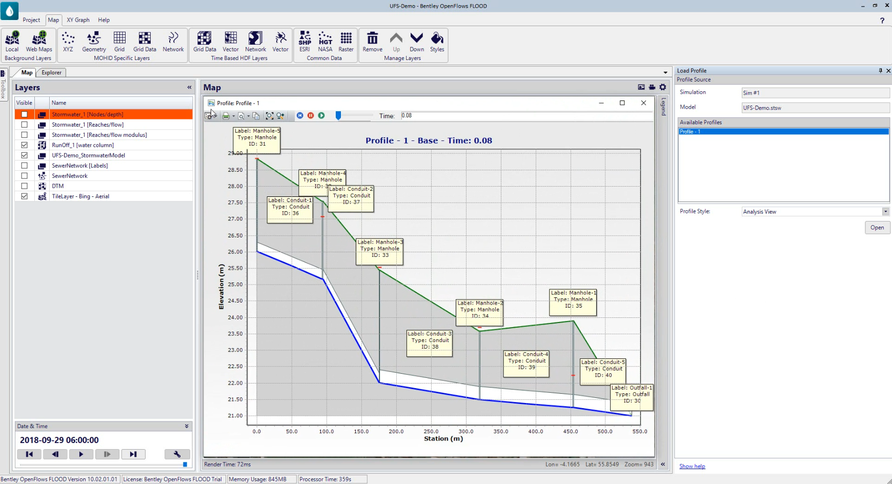

Hydraulic Profile View
If the SewerGEMS model which is linked with FLOOD using the new tool, contains profile views created prior to linking; then these will be available inside FLOOD. Using this tool, the available profiles are automatically listed, and the user can select and visualize the hydraulic profiles. Similar to SewerGEMS, the user is able to visualize both types of profiles i.e. analysis profile and engineering profile.
This tool can be accessed in the Toolbox Menu under Visualization (Toolbox > Visualization > SewerGEMS Profiles).

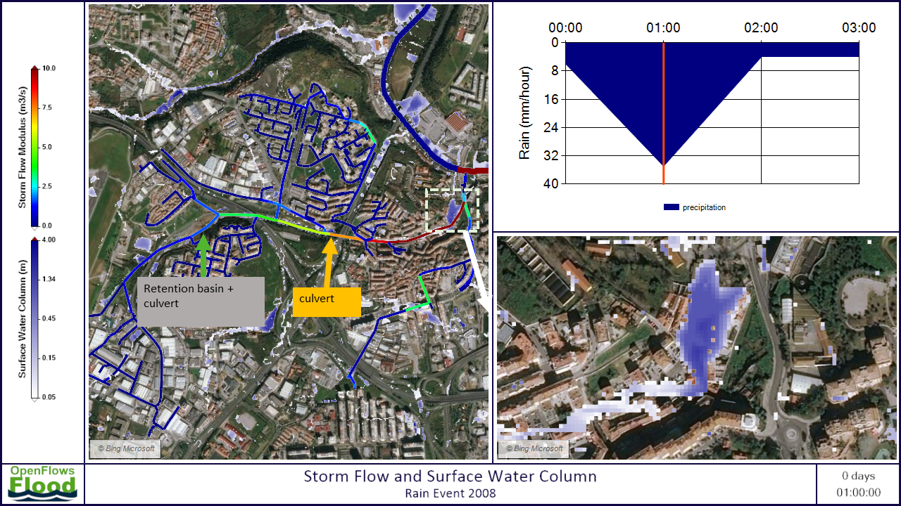

Also included is a new dynamic bidirectional link between 2D surface runoff using MOHID Land solver and channels (artificial and rivers) using SewerGEMS (SWMM) solver. This ensures more accurate and realistic results in cases where exchange between pipes and (natural or artificial) channels are present.
Integrated urban flood modelling (dynamic exchange between 1D open channels, 1D hydraulic structures such as culverts and retention basins) and 2D surface runoff

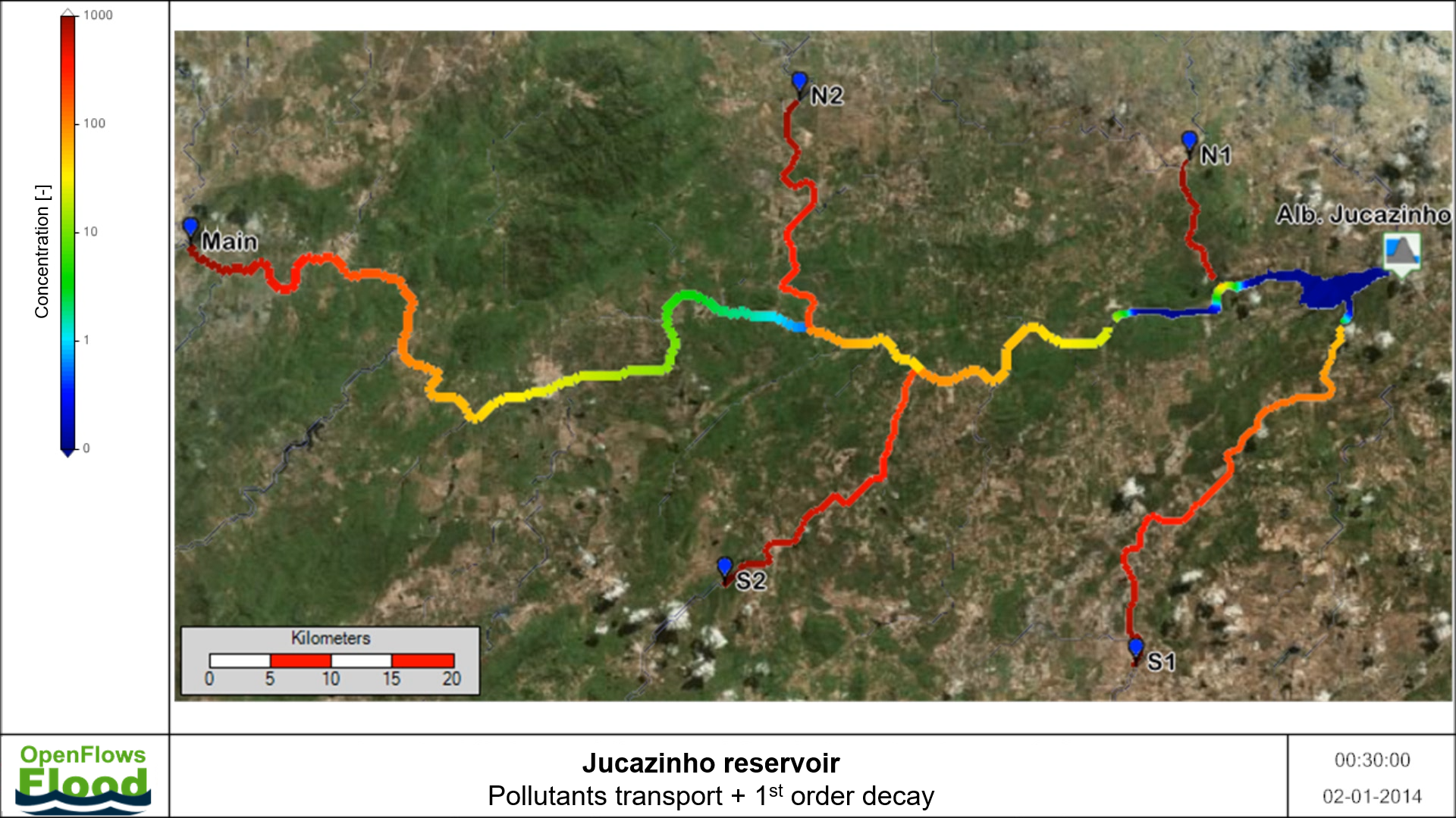

In addition to the existing capabilities, this release includes the MOHID water quality / water pollution comprehensive capabilities. Apart from property transport (advection-diffusion) in all mediums (coastal and inland surfaces, rivers, soil and groundwater), property transformation is also possible, either using specific and comprehensive water quality models or simple decay approaches.
This expands the range of applicable uses of FLOOD - for instance, allowing the study the water quality impact in a river or coastal area as a result of an emergency discharge (runoff) due to a storm event.
