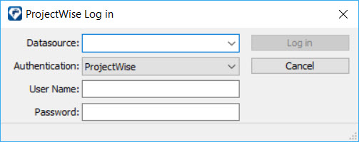

Once the integration is completed restart the program and go to File > Open. This should open up the ProjectWise datasource window. Enter the ProjectWise credentials for login and access to files stored will be available.

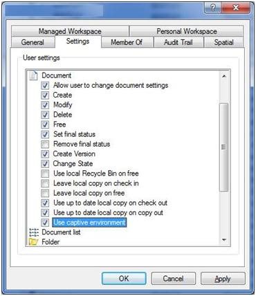

Enforcing ProjectWise use with Captive Environment
The term captive environment refers to the state of integration when the user cannot save documents to or open documents from the local file system. They are "captive" or forced to work in the ProjectWise environment.
Note that the local file open and local save dialogs can still be accessed if the user signs out of ProjectWise. Meaning, captive environment only works after the user signs into ProjectWise. The standard ProjectWise open and save dialogs will NOT open the local file open/save dialogs when cancelled, ensuring the users stay within ProjectWise.
However if the user simply double clicks a locally stored hydraulic model file (.wtg or .stsw for example) in the Windows File Explorer, it will still open in the standalone version of the OpenFlows application. However, if the user is using the MicroStation integrated environment, any files opened outside of Projectwise can be forced to be opened as read-only through setting the MS_READONLY variable, which will be respected when using the MicroStation integrated mode, as long as that variable is included in the OpenFlows application's respective workspace.

- Ensure captive environment is also enabled on the server side, for the ProjectWise users.

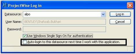

Single Sign-on and Auto-login support
· Single Windows login allow you to login each time you open Microstation or any other platform
· Auto-login gives you option to remember the data source next time you log into this application

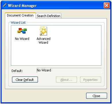

Document creation wizards
- No Wizard icon — Selecting No Wizard icon and clicking Set as Default means that the standard document creation dialog will open instead of the Advanced Document Creation Wizard. So when No Wizard is set, the Create Document dialog opens when you select Document > New > Document, and the Copy Document dialog opens when you select Document > Copy To. Also, clicking OK in the Create Multiple dialog will automatically create the specified number of documents (with no files attached), and copying or moving documents in ProjectWise Explorer using the drag and drop method will automatically perform the copy or move.
Selecting No Wizard here also ensures that if you attempt to create a new document in an integrated application, the application will open whatever ProjectWise dialog it normally uses to create new ProjectWise documents.
- Advanced Wizard icon — Selecting Advanced Wizard and clicking Set as Default means that the Advanced Document Creation Wizard will be used when creating documents. (The Advanced Document Creation Wizard Properties dialog controls which document creation actions will invoke the Advanced Document Creation Wizard.)
Selecting Advanced Wizard here also ensures that if you attempt to create a new document in an integrated application, the application will open the Advanced Document Creation Wizard.
- Clear Default / Set as Default — Clicking the Clear Default button signifies that you do not want to commit to a default document creation method. When you click Clear Default and the --no default wizard-- message appears in the dialog, this means that the Select a Wizard dialog will open whenever you select Document > New > Document, whenever you create multiple documents using the Create Multiple dialog, and whenever you copy or move documents using the drag and drop method. Clicking the Set as Default button sets whatever method (icon) you select from the list as the default method for creating documents.
Setting --no default wizard-- here also ensures that if you attempt to create a new document in an integrated application, the application will open the Select a Wizard dialog.
- About — When the Advanced Wizard icon is selected, clicking the About button opens an information box that provides — information — about the benefits of the Advanced Document Creation Wizard.
- Properties — Opens the Advanced Document Creation Wizard Properties dialog, which is used to specify which document creation actions will invoke the Advanced Document Creation Wizard, and which pages on the wizard will be hidden from the user.
