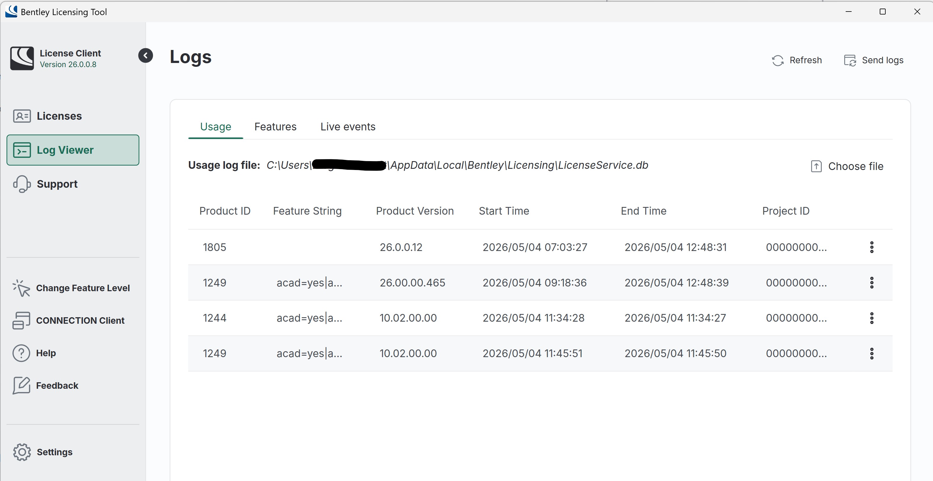

How can I monitor license usage and view usage reports, for Subscription Entitlement Service-enabled (formerly known as CONNECT Licensing) versions of the OpenFlows products?
Note: this article applies to Subscription Entitlement Service enabled versions (see above).
License usage can be reported and monitored from the Bentley Licensing Tool, Subscription Analytics report and the Product Usage report.
Reports current usage of Subscription Entitlement Service-enabled Bentley products on the client computer.
