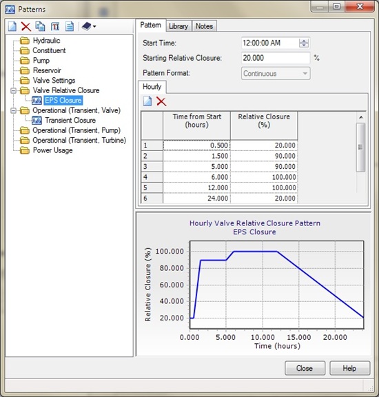

Option 2: Pattern
However, if you want to adjust the relative closure of a TCV based on time, you can create a pattern. Go to Components > Patterns and create a new pattern for "Valve Relative Closure." Set the starting relative closure to be the initial position of the valve. Then create the pattern that will be used by the program to adjust the relative closure of the TCV.
Note that this type of pattern works in conjunction with "Valve Characteristics Curve" selected as the "Coefficient type" for the TCV, and the pattern that you enter would be selected in the field called "Pattern (Relative Closures)".
If you are using "Headloss Coefficient" or "Discharge Coefficient" as the Coefficient Type, your pattern needs to be entered under the "Valve Settings" category in the Pattern manager, and selected in the "Pattern (Valve Settings)" field in the valve properties. In this case, the values entered in the pattern are multipliers, which multiply against the initial headloss coefficient (which is calculated, in the case of using the "discharge coefficient" type). So, a value of "1" on the pattern will cause the program to use the original initial headloss coefficient at that time. Therefore in order to close the valve using this method, you would need to use a very high multiplier in the pattern, such as 999999999999. So, in a situation where you need to open and close a valve based on time, it would be better to use the Valve Characteristics Curve type, or logical controls.

3) Enter your initial relative closure percentage in the TCV properties. Again, this is correlated to headloss by way of the Valve Type.
4) Enter and select your "Pattern (Relative Closure)" in the TCV properties. The Starting Relative Closure should be equal to the initial relative closure, and the pattern defines how the valve changes positions (stroke) over time. As this changes, the discharge coefficient changes based on the relationship defined by way of the Valve Type. You can view the corresponding headloss coefficient, discharge coefficient and total headloss for each timestep by looking at the Results section of the TCV properties or by graphing these attributes.
