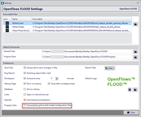

Go to the "droplet icon" on the top left corner and click Settings. Then un-select the option "Use property grid to edit model configuration files".
This will allow you to edit the model configuration files manually and add options that are not available via the user interface.
