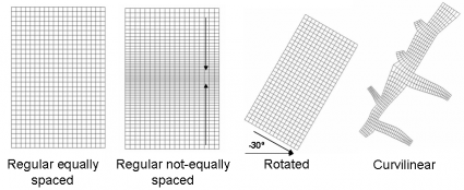

After adding the topographical data, a 2D computational grid needs to be created; as this will specify the locations and resolutions of the 2D cells, which will be considered in the interpolation process for the generation of the digital terrain data. OpenFlows FLOOD is able to generate different types of grids, illustrated in the next figure:
Figure 2 – Different types of grids generated by OpenFlows FLOOD

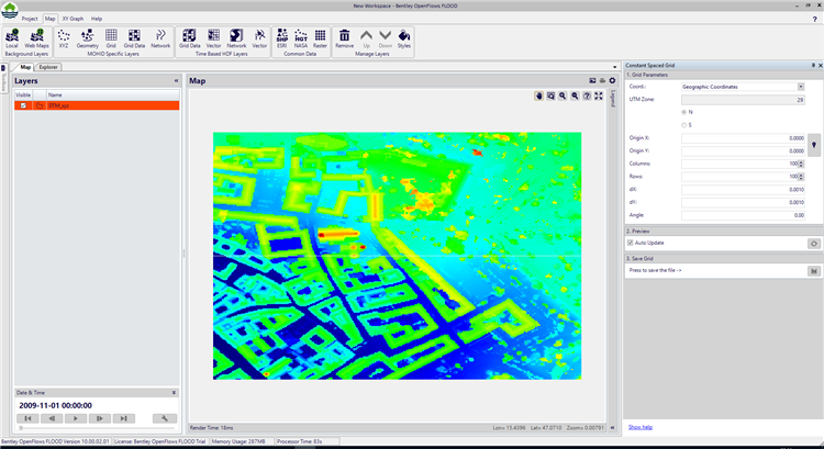

Open the Toolbox and double click on Grid > Create Constant Spaced Grid. This will open the “Constant Spaced Grid Tool” docked on the right of the main area. Your window should look like the one shown in the next figure.
Figure 3 – Create Constant Spaced Grid

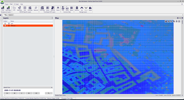

Then, you need to save the grid file, by clicking in the lower-right button  . After this you will be prompted to define the target path and filename. When the tool closes, the grid is loaded in the Map Window:
Figure 4 – Created grid / Map visualization

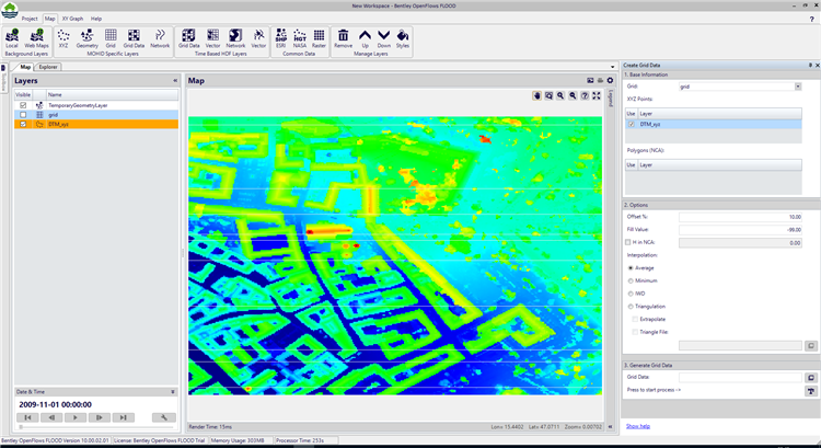

To generate a digital terrain file based in the topographical data select Toolbox, and then “Grid Data” and choose “Create Grid Data from XYZ Points” tool.
After double clicking “Create Grid Data from XYZ Points” the following data would be available as shown in the image below;
Figure 5 – Create Grid Data
We can now construct the topography with the following options indicated in the following table.

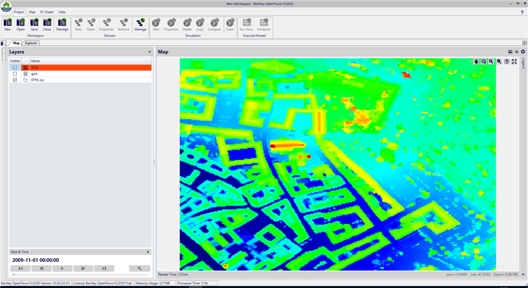

After filling all data, choose the process button ( ) to generate the topography. This process is finished when you see the following status message:
Figure 6 - Status message of the Construct Grid Data Tool
Close the status message and the tool window (using the x). Your main window should now like the one in the following figure.
Figure 7 – Visualizing Grid Data (Digital Terrain model)

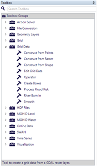

To generate a digital terrain file based in the existing Raster data, select Toolbox, and then “Grid Data” > “Create Grid Data from Raster” tool. Double click the tool to open it, as shown in Figure 8.
Figure 8 - OpenFlows FLOOD Toolbox for Grid Data layers
The tool window will appear docked on the right-hand side of the “Map Window” as Figure 9 shows.

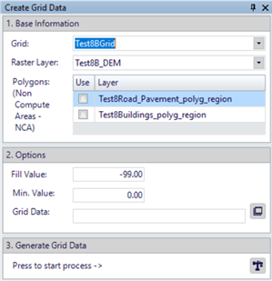

In options group “1. Base Information”, in “Grid”, select the grid layer corresponding to the model computational grid. In “Raster”, select the digital elevations raster layer. In “Polygons (Non-compute Areas – NCA)” you can select layers where you don’t want to calculate a solution. Ignore this option if you want to compute a solution in the entire model domain.
In options group “2. Options”, a “Fill Value” and “Minimum Value” select the default options and in Grid Data select the path to the Grid Data file to be created.
In options group “3. Generate Grid Data”, press the button to start the interpolation process and wait for a message box stating that the Grid Data file has been generated. Press “OK” and the Grid Data file will be automatically loaded in to the Map view.
Figure 9 - Create Grid Data (DTM) from Raster
