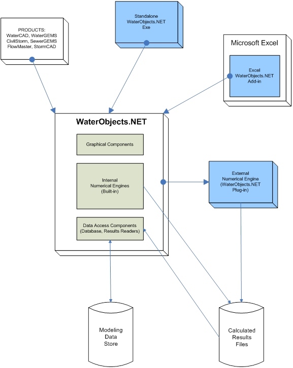

Waterobjects.NET is the Application Programming Interface (API) used with Bentley's Hydraulics and Hydrology (OpenFlows) products, such as WaterCAD and WaterGEMS. It allows users with programming knowledge to extend the functionality of the product to suit their needs. Being .NET Framework-based allows support for a number of different programming languages, such as VB, C#, C++, etc (more information on that can be found here and here.)
Waterobjects.NET essentially provides a way to code routines/tools that take the data in a hydraulic model file, manipulate it in some way and either present output in a certain way and/or modify the model data. It is not intended as a way to modify the existing numerical engines or the user interface. Source code for those components are not provided.

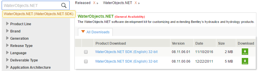

If you have the product already installed (SewerGEMS, WaterGEMS, etc) then you already have access to program with Waterobjects.NET. There is no separate installation file necessary. However, if you are a member of the Bentley Developer Network (BDN), then you can download the Software Development Kit (SDK) from our Software Downloads site (contact Technical Support if you have BDN and the download is not available), which is essential for learning how to program a WaterObjects.NET tool. The Waterobjects.NET SDK includes Programming and Sample guide documents as well as several samples (mostly written in C#). This will help guide you through how to use Waterobjects, though in most cases a high level of programming experience will be necessary as a prerequisite.
Note: there is not a separate documentation and language pack for WaterObjects.NET. Everything is included inside the main SDK download.
If you are unsure if you are a BDN member, contact your Bentley Account Manager or click the "contact" button here.
Note also that even if your organization is a BDN member, your Administrator will need to ensure that any individual users that need to download the SDK have a “Bentley Developer Network - Download” role, AND a “Product Delivery – Download” role – the latter is required for the former, it is mentioned in the following article: Available Roles
