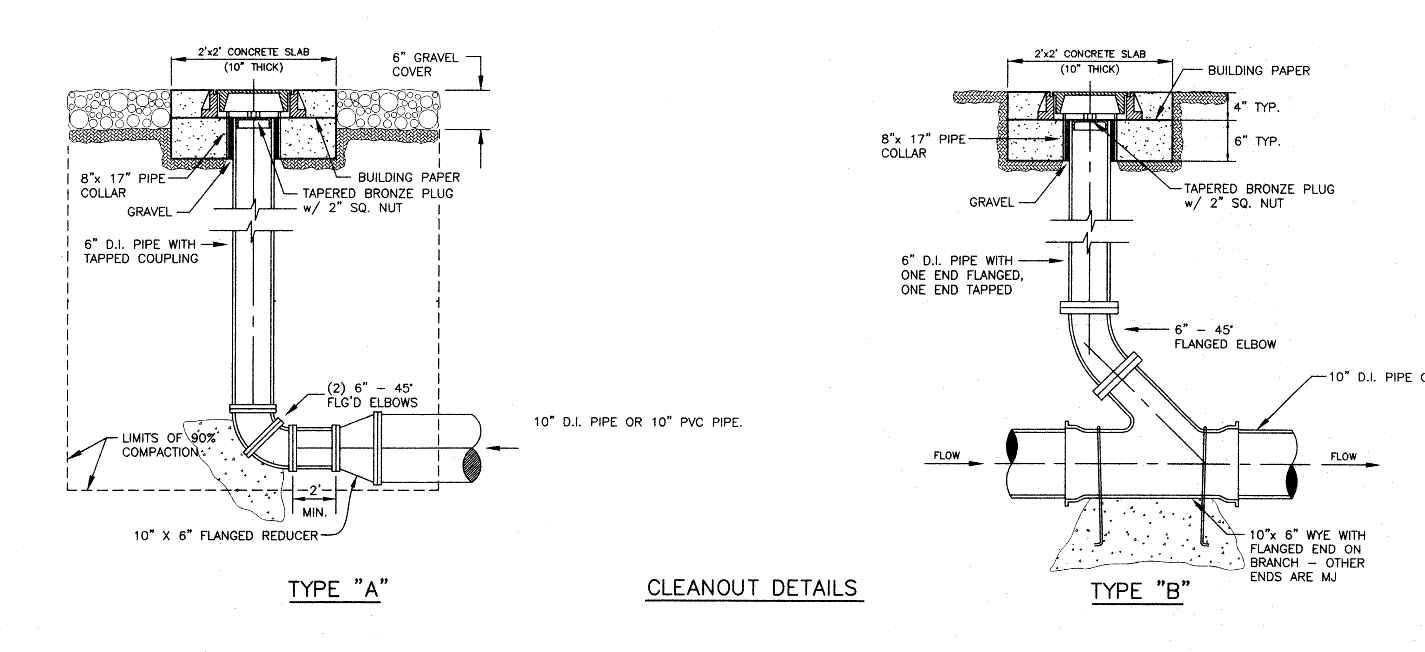

Case example 1: Clean Out
I'd like to model a clean out on a force main, but I don't see a clean out element. How do I model this? (Using SewerCAD)
Process
1) Think about exactly what the element does hydraulically in the real world and how it functions. What is the purpose of it? How does this relate to the end goal of this model?
The element just needs to be represented in my model and I don't believe there is any significant effect caused by it hydraulically, but I'd still like to represent it as accurately as possible.
What you should be thinking
In this case I may not need to model the clean out at all, but I should take a look at a few options just to make sure my model is accurate. There is only one solver in SewerCAD, so I don't have to worry about question 3 and we're using a very general goal for this model, which is to just model what we have as accurately as possible. Given the aforementioned information I can skip to step 4 to start looking at the different model elements I might want to consider.
2) I know that my clean outs can look like either of these setups in the screen shot below, so I'm going to layout a manhole, pressure junction, transition, and a pressure pipe to examine the properties of each of those elements.

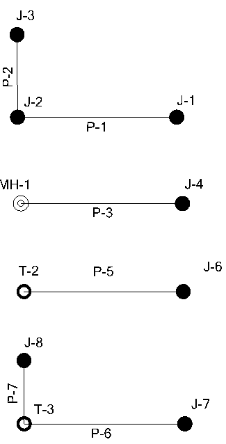

In the first configuration at the top J-3 represents the top or cap of the clean out and is at a higher elevation that J-2 and J-1. There are also minor losses entered on one of the pipes that represents the 45degree bend.
The second and third configurations are similar. The manhole or transition would represent the length or depth of the clean out. I'd do this by making the rim (crown) elevation higher than the invert elevation. The advantages that the manhole configuration has over the transition are that can be defined are the diameter of the clean out pipe via the manhole diameter and the ability to define a bolted cover. The transition element doesn't have these features, so the third configuration probably won't work.
The forth configuration is sort of a combination of the first and second, but uses a transition at the connection point between the clean out pipe and the carrier pipe. The only real differences between this option and the first one is that you can add a transition length to the element and define any headloss via one of the methods.
 3) The next steps in the process are 6 and 7.  You could put a reservoir on one end and see how this configuration works for you in a sample model, but since this is a simple case you might just want to add one of these at a time to your model, compute the model, and make an engineering judgment as to which you think best models the results you're expecting. This would also be a great place to take advantage of the power of the scenarios and alternatives. You could make 3 different scenarios and try out each the 3 configurations then compare their results.
