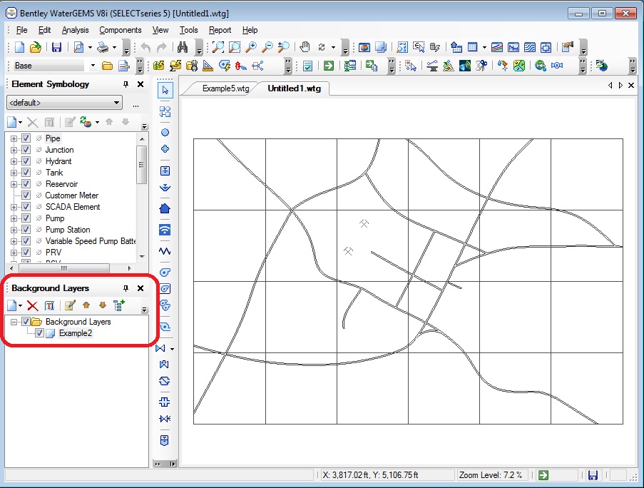

One of the benefits of working in AutoCAD or MicroStation integrated mode is to see your model along with any other CAD linework (referenced in drawings for example). However, the Standalone platform can display CAD files as a background layer. This allows you to see the linework and trace over it as you lay out elements, if you desire.
To do this, open the Standalone version, start a new model or open an existing model, then navigate to View > background Layers (it's typically open by default, in the lower-left corner.) Click on the New button and choose File, then select your DXF file. In the DXF Properties window that appears, choose the unit, transparency, color, etc and click OK. You should now see your CAD file as a background in the plan view of the drawing. If you do not see it, click View > Zoom > Zoom Extents.

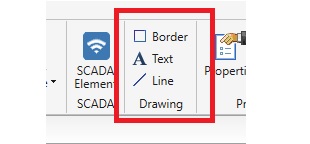

The Standalone version includes additional drawing features that can be used for additional annotations or to call out elements of the model where element symbology cannot.
From the Layout tab, the "Drawing" section includes the border (rectangle), Text (custom text box) and Line tools. See more here: Using Text, Line, and Border feature

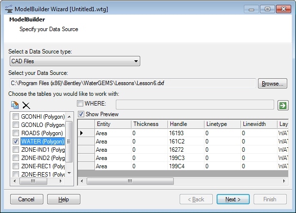

Using a CAD file background as a guide to trace your water elements can be helpful, but existing linework can also be automatically imported and converted into hydraulic elements using the ModelBuilder tool. This is useful if your elements (Pipes, conduits, junctions, etc) already exist in your CAD file and you simply want to create a hydraulic model.
To do this, you will need to first save your drawing in the DXF format, then go to Tools > ModelBuilder. For more on using ModelBuilder to import a CAD file, see the below Support Solution: Importing an AutoCAD or MicroStation CAD file using ModelBuilder

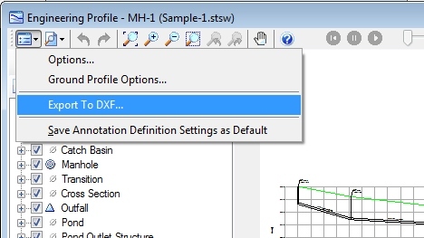

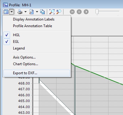

2) To export a profile in SewerCAD, SewerGEMS, CivilStorm or StormCAD, open the profile, click the Options button in the upper-left corner and choose to Export to DXF.
