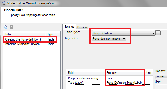

6) On the field mapping step you are going to map the sheet that called "Creating the Pump Definition" to the table type titled "Pump Definition". In the example, the "pump definition importing" column is the key field. This is the label that you are going to call your pump definition in WaterCAD or WaterGEMS. You will want to map this 'pump definition importing' column to the WaterCAD/WaterGEMS property 'Label' and map the "Type (Label)" column to the property of Pump Definition Type (Label).

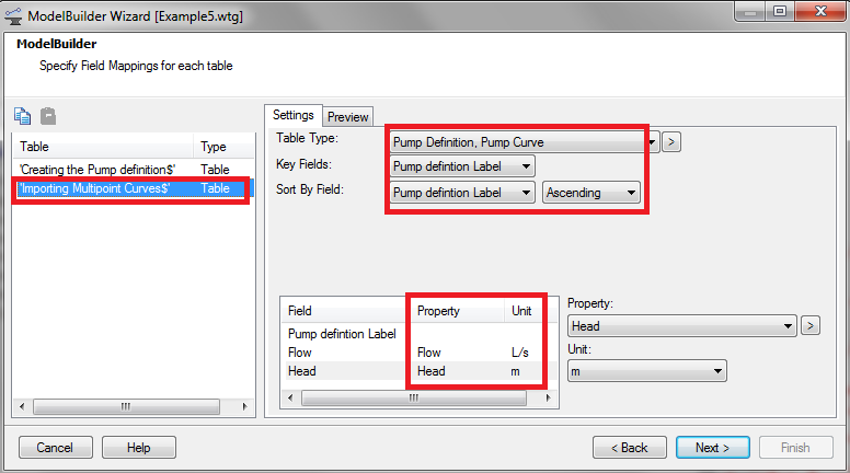

7) On the field mapping step, select the sheet called "Importing Multipoint Curves" and set the Table Type to "Pump Definition, Pump Curve". In the example, the "pump
definition label" column is the key field and contains the label names for the pump definitions you are having ModelBuilder create in step 6. In the column mapping you will only map the Flow and Head fields.

7)  On the field mapping step you are going to map the sheet called "Creating the Pump Definition" to the table type titled "Pump Definition". In the example, the "pump definition importing" column is the key field. This column name is the label name of your pump definitions in WaterCAD/WaterGEMs. You will want to map this 'pump definition importing' column to the WaterCAD/WaterGEMS property 'Label' and map the "Type (Label)" column to the property of Pump Definition Type (Label). See the screen shot below.
7) On the field mapping step for the sheet called "Importing Multipoint Curves", set the Table Type to "Pump Definition, Pump Curve". In the example, the "pump definition Label" column is the key field and contains the label names for the pump definitions you are having ModelBuilder create in step 6. In the column mapping you will only map the Flow column on the sheet to the Flow property in WaterCAD/WaterGEMS and map the Head column to the Head property in WaterCAD/WaterGEMS. Make sure to select the correct units. See the screen shot below.

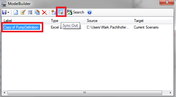

9) With the Modelbuilder run highlighted in blue click the  "Sync Out" button to export your definitions to your spreadsheet.
