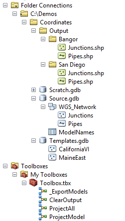

The overall data structure for this example is shown here:

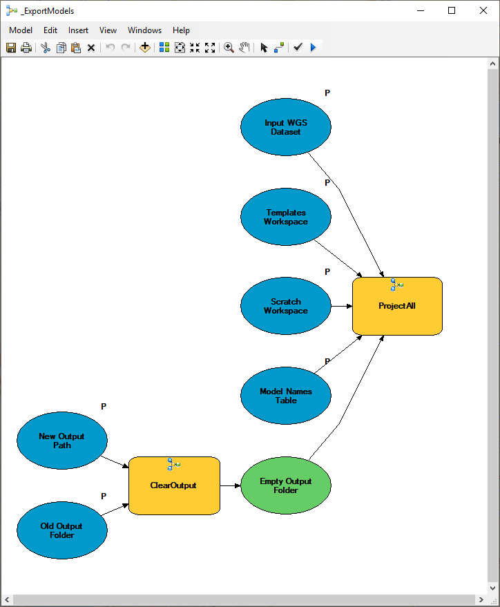

The automated procedure has been separated into four tools, due to how ArcGIS Iterators behave. The main tool that is run by the user is called "_ExportModels". This can be pre-configured with all required parameters, so the user may simply run the tool with default parameters to update the intermediate data for all feature classes and for all models.
The main tool first calls a sub-tool to clear any old results, and then calls a sub-tool to perform the projections.
Export Model Tool

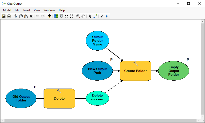

The ClearOutput tool first deletes the output folder in order to remove out-of-date results, and then recreates an empty output folder.
Clear Output Tool

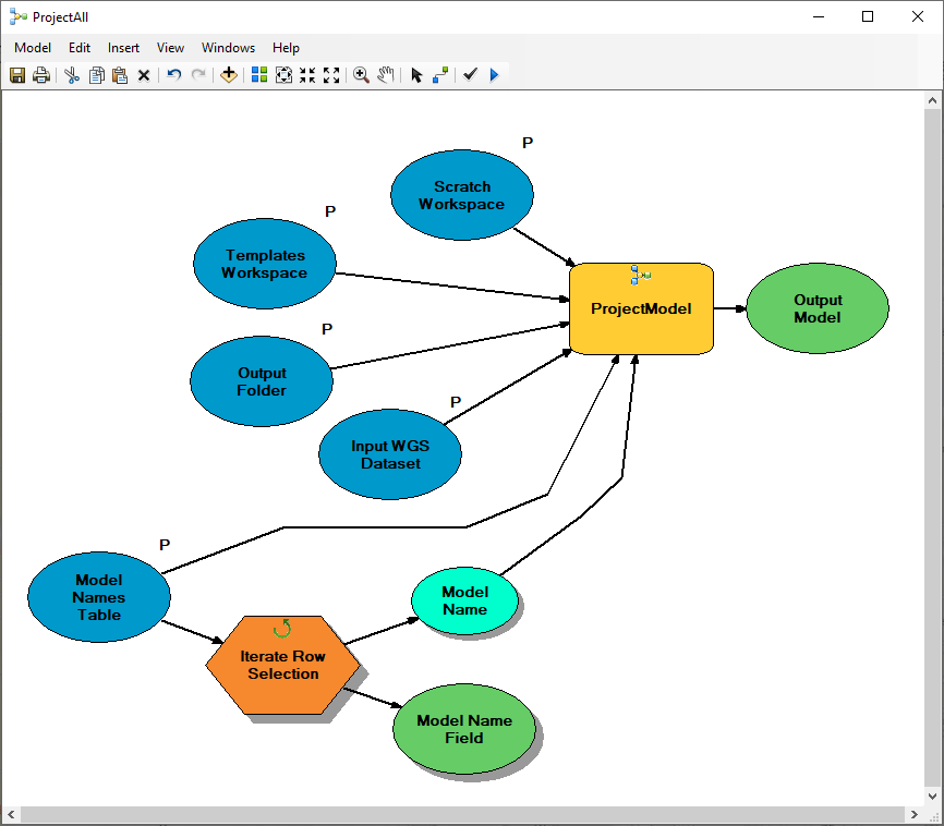

The ProjectAll tool iterates through the table of Model Names. For each Model Name, it calls the ProjectModel tool.
Project All Models Tool

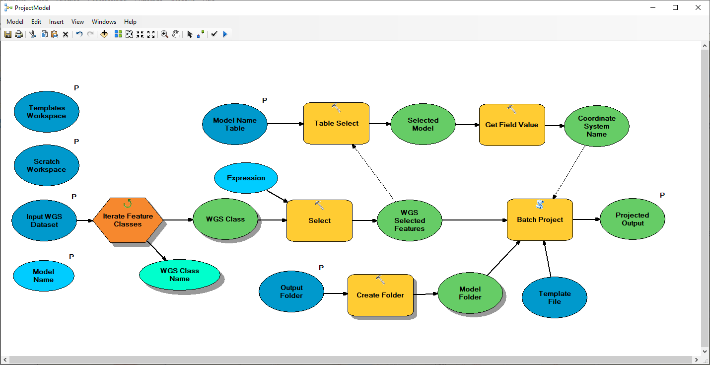

The ProjectModel tool creates a subfolder in the output folder for the specified Model Name, and looks up the appropriate coordinate system name. It then iterates through all feature classes in the Source dataset (such as Pipes, Junctions, etc.). For each feature class, it filters down to just the elements which have the given Model Name, and then projects this subset of features into the appropriate coordinate system.
The Template file is an empty feature class that has the appropriate coordinate system assigned. This is stored in some stable location and given a short descriptive name which is used within the ModelNames table.
Model Table
Project Model
