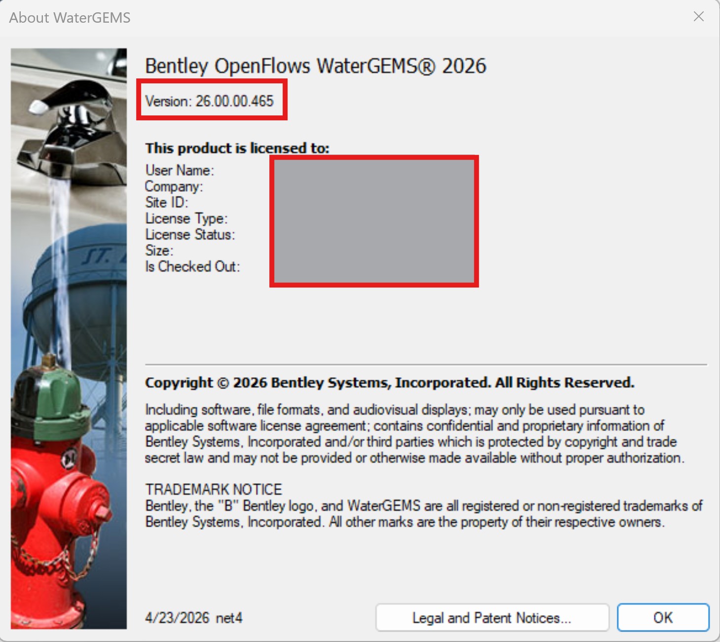

How can I find my registration / license information and version number / build number for my OpenFlows products?
Option 1
Inside the program, this is found under File > Help > About [product name]. In older versions it is found under Help > About > Product Name > (i.e. Help > About WaterGEMS).

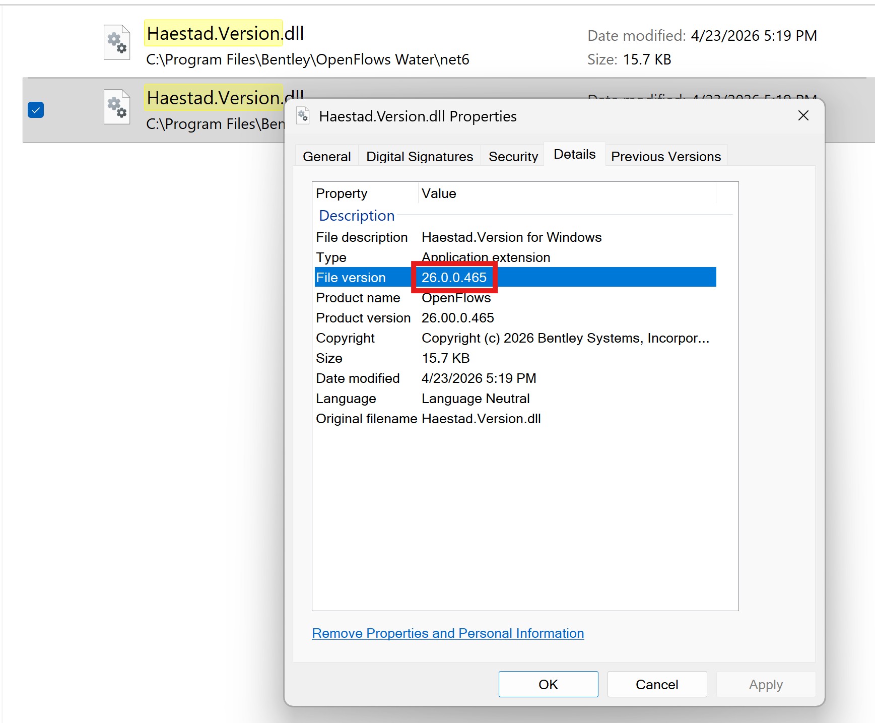

Option 2
You can also find the version number by going to the install folder of the product (i.e. "C:\Program Files\Bentley\<Product_Name>") and locating the "Haestad.Version.dll" file, right clicking on it, choosing 'Properties', and locating where it says, "Product Version" on the Details tab. *This is starting in version 08.11.06.113 +.
