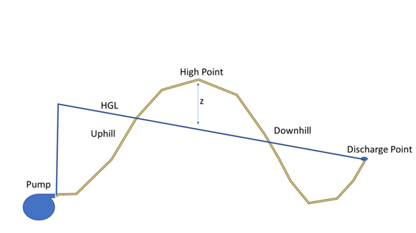

Modeling the pump and pipe as a single pipe without accounting for intermediate high points can yield some misleading results. It will usually show a result as the profile below.
Figure A: Operation as siphon
Will the pipeline shown above work? The figure shows the pipeline operating as a siphon. This may work if z is very small. In areas where the pipe is above the hydraulic grade line (HGL), the pressures are negative; something that is not allowed in potable water distribution piping.  But there are some problems with this design. First, is the flow sufficiently large and the downhill pipe slope sufficiently flat that the pipe will flow full? If the downhill slope is small or the flows low, the pipe will never reach full flow and siphon will not be established. Second, if z is greater than 32 ft (9.2 m), the liquid water will be below the vapor pressure of water and the siphon will never form. Third, even if the siphon works, eventually gases will collect at the high point and reduce the pipe capacity.  This design is generally not recommended.

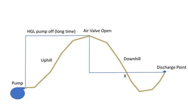

So, how does this piping over the hill work? If the pump has been off for a non-trivial length of time, the downhill sloping portion of the pipe will drain but water will be found in the uphill pipe and any pipes below the discharge point as shown below.
Figure B: HGL when pump off

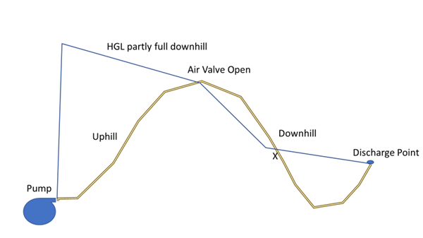

When the pump is turned on it gradually fills the downhill section. When the runtime is short, the flow is low and the downhill slope is large, it may never fill the downhill pipe. The places where the HGL is below the pipe are those that are flowing partly full. Full pressure flow resumes where the HGL crosses the pipe elevation (the "x" in the below diagram).
Figure C: Pipe filling

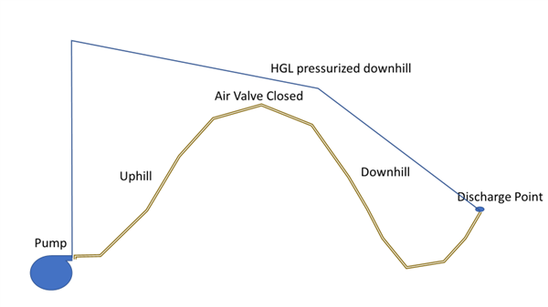

Eventually, if the flow is sufficiently large and the slope is mild, the downhill pipe will fill and the HGL will be above the air valve, which will close. However, this may not occur in all cases, as it depends on the slope of the HGL (once a "steady state" has been achieved) and topography. Use the hydraulic model to help you predict whether the whole pipeline will be pressurized or if part-full flow will remain even after the pump has been on for a while.
Figure D: Pipe full

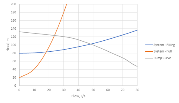

Pump Selection and System Head Curves
Pump selection in this case can be tricky. There will be a different system head curves depending on whether the pump is just pumping to the top of the hill vs. the case once the pipeline is full. Any pump selection needs to consider both cases.
For example, consider a pipeline with a high point. If it is modeled as completely full, the system head curve is based on the entire pipeline. If the pipeline is filling, it is modeled only from the pump to the high point (set the system downstream of the high point to Inactive and place a reservoir at the high point for that scenario. The two system head curve and the pump curve are shown below.
System Head Curves
The blue system head curve represents the case where the pipe is filling. It has a high static head. The orange curve shows a much steeper slope because, in this case, the length of pipe causing friction head loss is very long compared with the length to the high point. The gray line is the pump head curve. The flow from the pump will be on the order of 50 L/s as the downhill pipe fills but will drop to about 25 L/s once the pipe is full. It is difficult to find a pump that will run efficiently over that range of flows. This will not always be the case as each pipeline is different.
